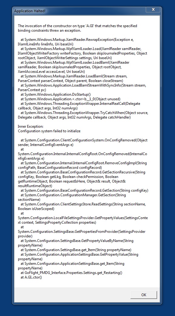

Last night I had a electrical blackout in the whole house while flying.
After power returned I wanted to fly again, but after opening GIT 3.6.6.1 (you sent me) I received a warning window - see attached screenshot.
No chance, even after UN and REinstalling GIT to open... always the same error(s)
This appears only to GIT for P3d, my GIT-Xplane works without any errors on XPL11
PLEASE HELP ME - I have no more ideas!!! :'(

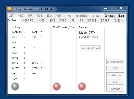

  • 1st update:
    after performing a windows recovery to yesterday´s status I was able to open GIT again.
    works normal with standard plane, but when I load PMDG777 GIT freezes, all three status lights from green to off and I can´t even close GIT without task manager.
    glad for any help, been hanging in that for hours now...
    Alex
  • It sounds like your config files have got corrupt. You need to restore from backup. There is a backup directory in Documents\GoFlight Interface Tool but I suspect these have now been overwritten with the broken ones because you got GIT started again. Hope you have a backup somewhere else!!!

    little discouraging UPDATE:
    After clean install (P3d, GFConfig, GIT3.6.6.1 ) I still get the warning... see attached.
    Sim itself runs perfectly, about 70fps with standard plane, PMDG not yet installed.
    So what to do next???
    Think I get hopelessly lost now
    Alex

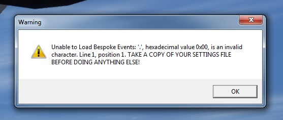

  • btw: which XML tool are you thinking of? DLL.XML???
  • If you edit the bespoke events.xml file in Documents\GoFlight Interface Tool and delete the first < on line 1 position 0 and then put it back again, it should fix it I think.
  • ok, I´ll try right now and give you a message
    thanks Steve!
  • This file is completely empty!!!!!!!
    Not even ONE character in there!
  • Its been wiped then from the power cut. How about the backup directory? If no good, just delete the file and GIT should start, but all your Bespoke Events will be gone.

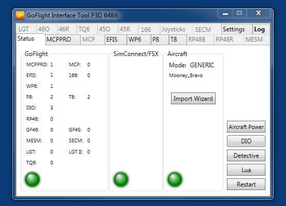

    Seems to work for drfault planes now but not for PMDG, freezes aqnd can´t be closed without task mgr.
    Any more files to delete?
  • Try deleting the PMDG.xml file, but you will lose your config data for all PMDG aircraft.
  • all assigning saved via export tab
    but I´ve just seen that I can assign a switch or button for the mooney, but no action in the sim
    but says synchronising switches and selectors complete!
    So where´s the bottleneck here?

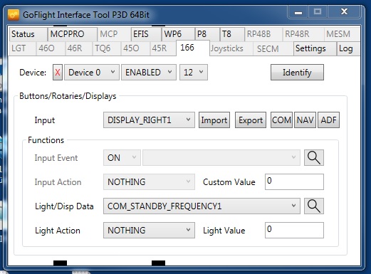

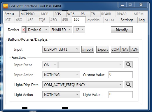

    OHP working, P8 working, just the damned GF-166 makes me crazy... the left display won´t change values on swapping frequency - settings should be ok (attached) - IDEA?
