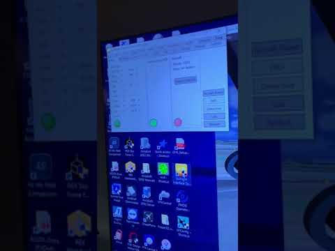

Video B747 not working:
All lights are green????
I had no trouble before I reinstalled to 4.5 plus HF. Sucks not to be able to get the 747-800...
There is little I can do about it because having reviewed the Simconnect logs with a previous customer with the same problem with the NGX, GIT was doing everything right but either the PMDG SDK or Simconnect did not respond to GIT. I suspect its a bug in 64bit Simconnect which appears in certain situations, but why it is only impacting on the 747 and not the others is very odd. It could also be a clash with an addon.
Since it was working before, can you list everything you did and in what order so we can try to determine the cause.
You must also make sure you have the latest version of the 747 installed, it wont work with older ones.
