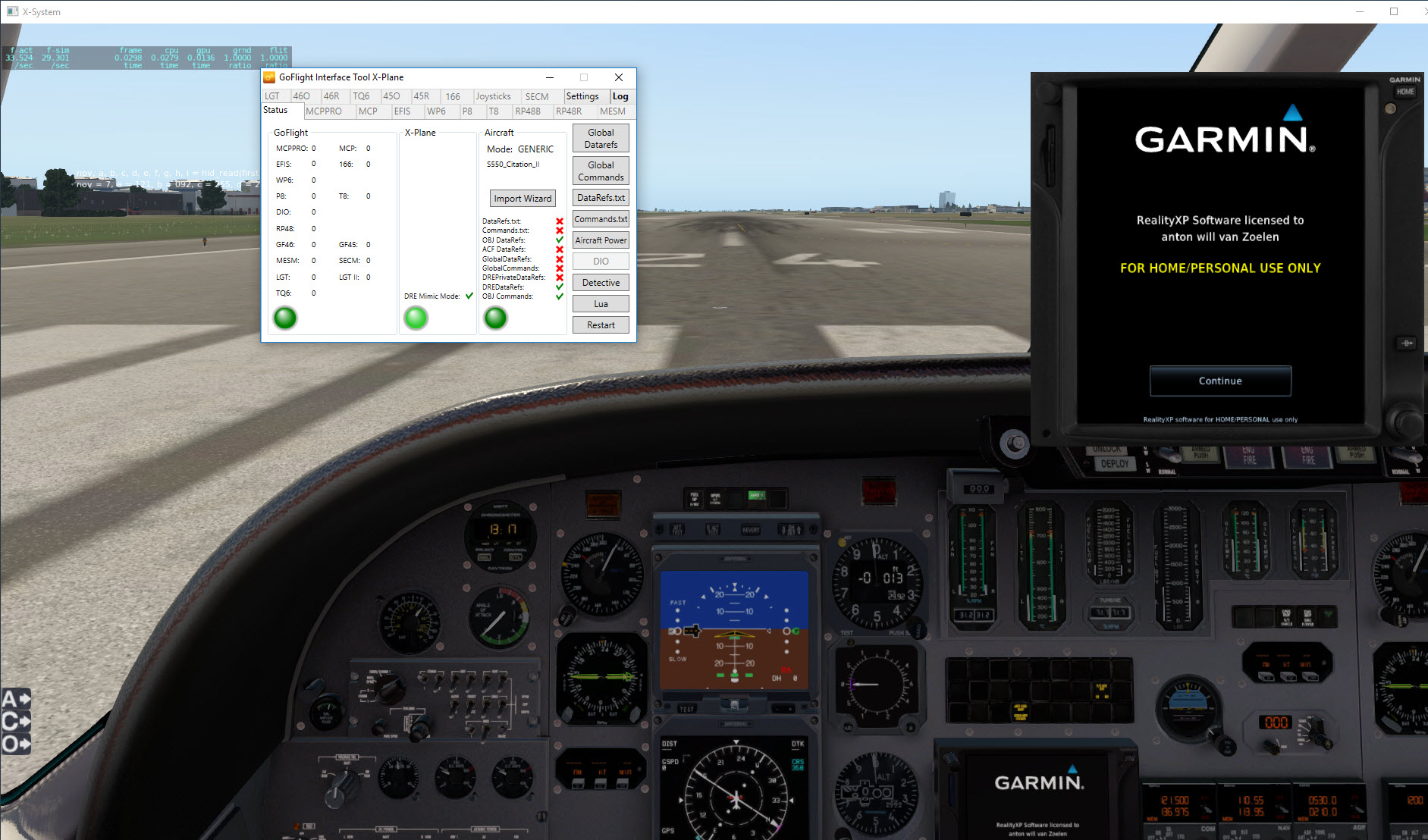

Just bought a lot of Goflights modules and your software for Xplane. As the Goflight site is down I can't find and download the latest Goflight-drivers.
I did not get the drivers or any other software for the Goflight-modules.
As stated that you don,t really need them but the interface does not show the devices which are connected (no USB 3.0). Only the lights of the GF-MCP show, no GF-166A, GF-48, GF-T8 or GF-P8. Have included a screenshot.
Any help is highly appriciated.

  • Hi Steve...did find the file GFConfigSetup_2_28_0.zip and installed the program. Is for FSX and Prepar3D. Does the program install the necessary drivers to work with pollypot? Pollypot does not find any modules (see jpg in earlier message....any advice...?
    Thanks a lot for your help.

  • Hi Steve.....program works now...seemed a usb-problem with connecting, is solved now...thanks for your time..
