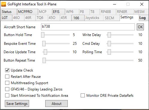

I've had intermittent issues with the lights on the MCP Pro. I played around with the settings (and I've attached a shot of what I have). if the lights don't work when pressing/toggling them from the MCP Pro, I just use to recycle the button/switch and it would appear to work. GIT must do some sort of polling of the devices but seems to miss some state changes.
On the other hand, if you click on the button/switch in the sim, the MCP Pro is updated straight away.
