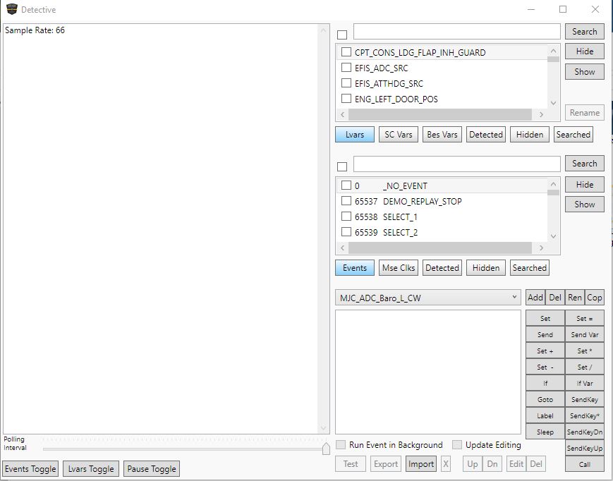

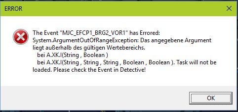

    Yesterday I made another test. If I start P3D, load the default flight, start GIT and switch to the Dash I get those errors for every bespoke event. I posted one of those error screenshot above. At this moment I have to click the OK button for every error in the message Then I have to delete every bespoke events in detective. The red X to delete the bespoke events doesn't work anymore. This behavior happens everytime I switch from an other plane to the Dash. If I directly load the Dash there are no errors and the HDG digits doesn't work correctly until I import the MCPPRO.xml.

    if you get that error  don't bother trying to close every window that opens, just close GIT( ctrl alt del and close with task manager)
    The reason the big red X does not work is the same as before, the bespoke event you have selected must contain some code, if it's empty the red X is disabled, just pick a different event with something in it,  now the delete all will work again. if all your events are empty then just put anything in an empty event and now the delete all will work again.

    I just tried what Martin said and now I get the error on my system too, if I start with a different aircraft and then switch to the majestic it deletes all my bespoke events.

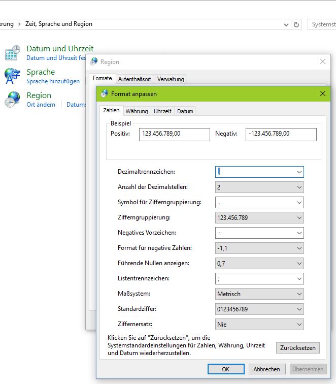

  • As Steve (Slayer) wrote, I've made a screenshot my Win10 Pro (German) Keyboard setting.

  • Hi Martin,
    I know this is a big ask; but could you try changing the Windows language to English. Clear out the Bespoke Events and config of the MCP PRO and try again.

    If I start with a default aircraft and then switch to the majestic I start getting errors like his screenshot above. All the events error and if you look in detective they are then blank.
    at this point you can't shutdown GIT because every event is causing an error and have to use task manager to shut it down. After a restart the events are back.

  • Hey Steve,
    It looks like it was a language issue. I gave Martin a new version of GIT  that reinforced the language as English US when running the import/export code and he is reporting its working with your old profile. This should not have been necessary and more testing is to be done at his end, but so far it looks like a result!
