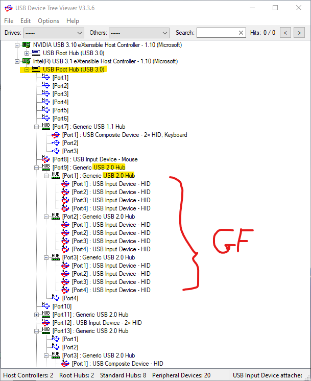

See attached file for my USB configuration.
