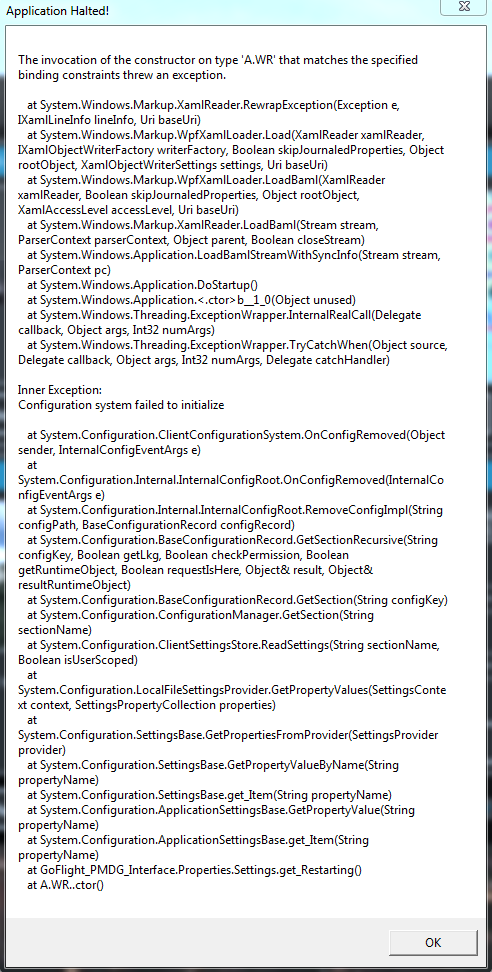

Message au lancement
Je reçois ce message pour la première fois
je ne sais pas ce qu'il veut dire ni pourquoi je le reçois?
This is an XML error and indicates that your settings file is corrupt or your GIT config files are corrupt.
First, delete everything in
C:\Users\[Your UserName]\AppData\Local\PollyPot_Software
and then start GIT again. If that doesn't work, renameDocuments\GoFlight Interface Tool
to something else and then start GIT again. If that works you will need to restore your config from a backup. Note there is a backup folder in Documents\GoFlight Interface Tool.Best wishes

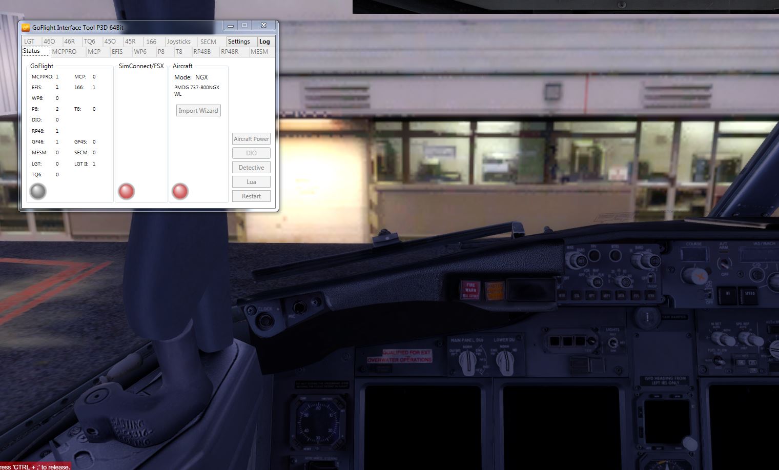

impssible to move or close the window GFIT no restart
I am very desapionted
I'll do it right away
I had another problem; The module P8 don't worke neither ?????
I think i'll have to formate and install all my system. from Windows 7 to end
I'll tell you
