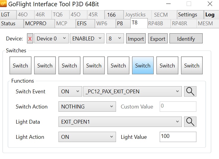

The switch operates the door correctly but I cannot get the LED to illuminate. In the Light Data dropdown I have selected EXIT_OPEN1, Light Action is ON and Light Value is 1.

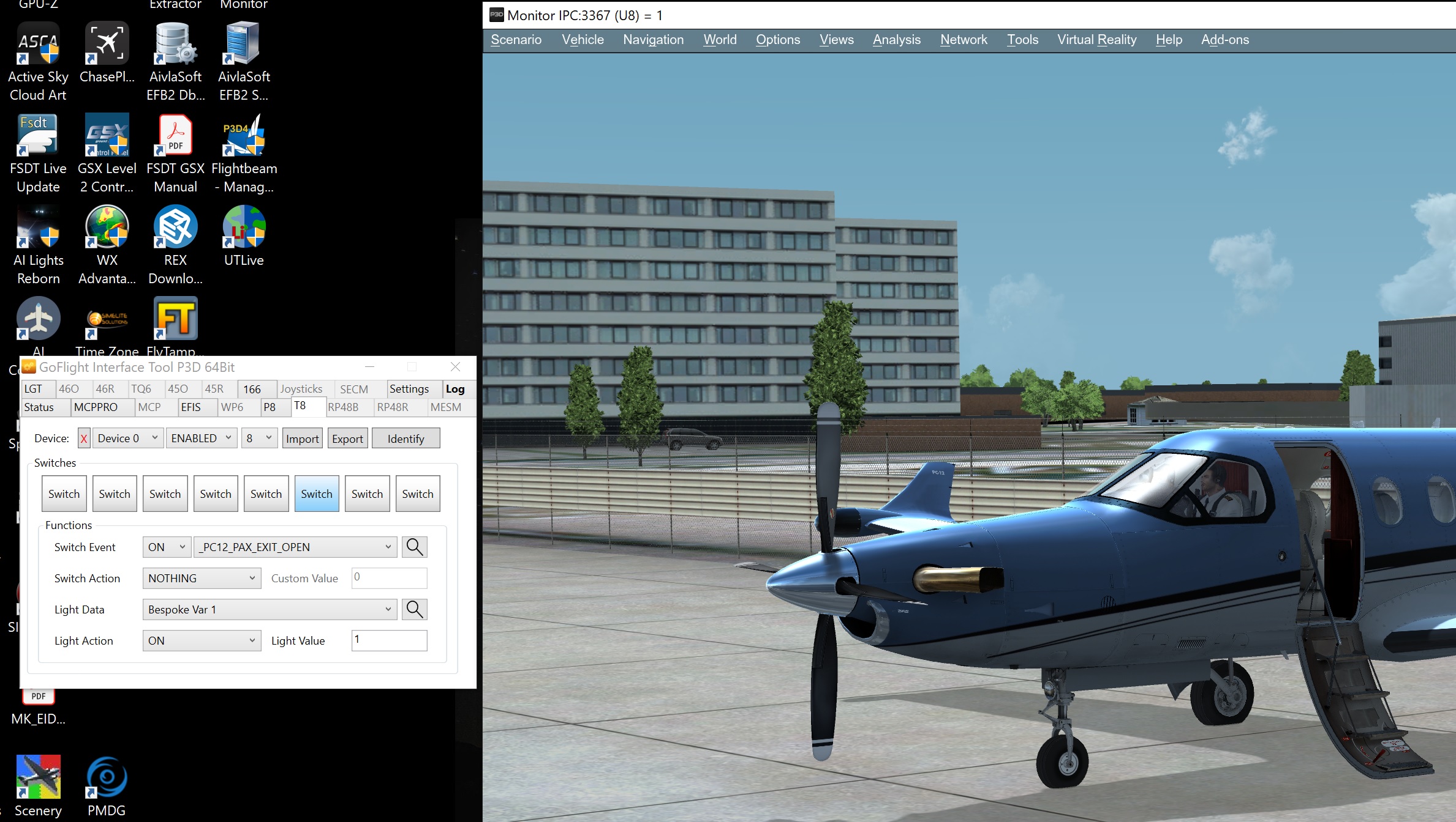

Monitoring FSUIPC Offset 3367 it correctly shows the value of the exit that is open - 1 - so the selection above seems correct. Any ideas why the LED won't illuminate when the door is open?

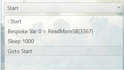

All I can suggest at this point is to create a Bespoke Event that can read the FSUIPC offset. Name it Start and it should contain something along the lines of this so it loops continuously:
:Start
BespokeVar0 = ReadOffset(FSUIPC offset number here)
Sleep(1000)
Goto :Start
And then assign BespokeVar0 as the light data on your T8 LED.
Note that start Bespoke Event only runs when GIT first loads the aircraft, so you will need to quit GIT and start it again to get the start event running.

Installed new version and selection of FSUIPC type now available. The critical line is
Bespoke Var 0 = ReadMemUB(3367).

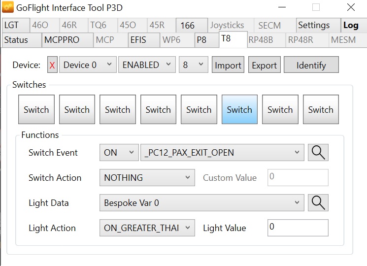

However, despite assigning the T8 switch to Bespoke Var0 whilst the pax door opens the led status doesn't change. Do we need a condition setting? 0 = both exits closed. 1 = Exit1 open. 2 = Exit2 open. 3 = Both Exits open. Those are the values when monitoring that offset.
If 3367=0 then led = off else led = on.
Thoughts?

Is there a way of checking this procedure is reading that offset correctly? Can it be displayed at all?

Can't follow your last comment, sorry. Yes, I have restarted GIT but despite trying all options the LED will not come on whether exit 1 is open or closed.
Are you basing this on theory or have you coded it as I have and assigned it to a switch?
Just to confirm I want LED to come on when door is open and go off when door is closed.
