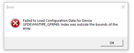

I have 2 RP-48 and programmed it correctly without any problem. So backup with export the configs of two devices. On another day i want to fly and started GIT, i experienced that devices where swapped. So device 0 become 1 and vise versa.
So when i try to correct it by importing the files again the first device (which is now 0) succeeded. But now with the other device import i got an error resulting in a import failure. (see screenshot)
What is the problem and the solution for that?
(also xml files included)
  • Try wiping the configs for both devices and then try again.
  • Wiped the complete git directory did not solve it. Started with clean xml file and paste everything in it again solved the problem. Looks like a wrong char made the import failed
