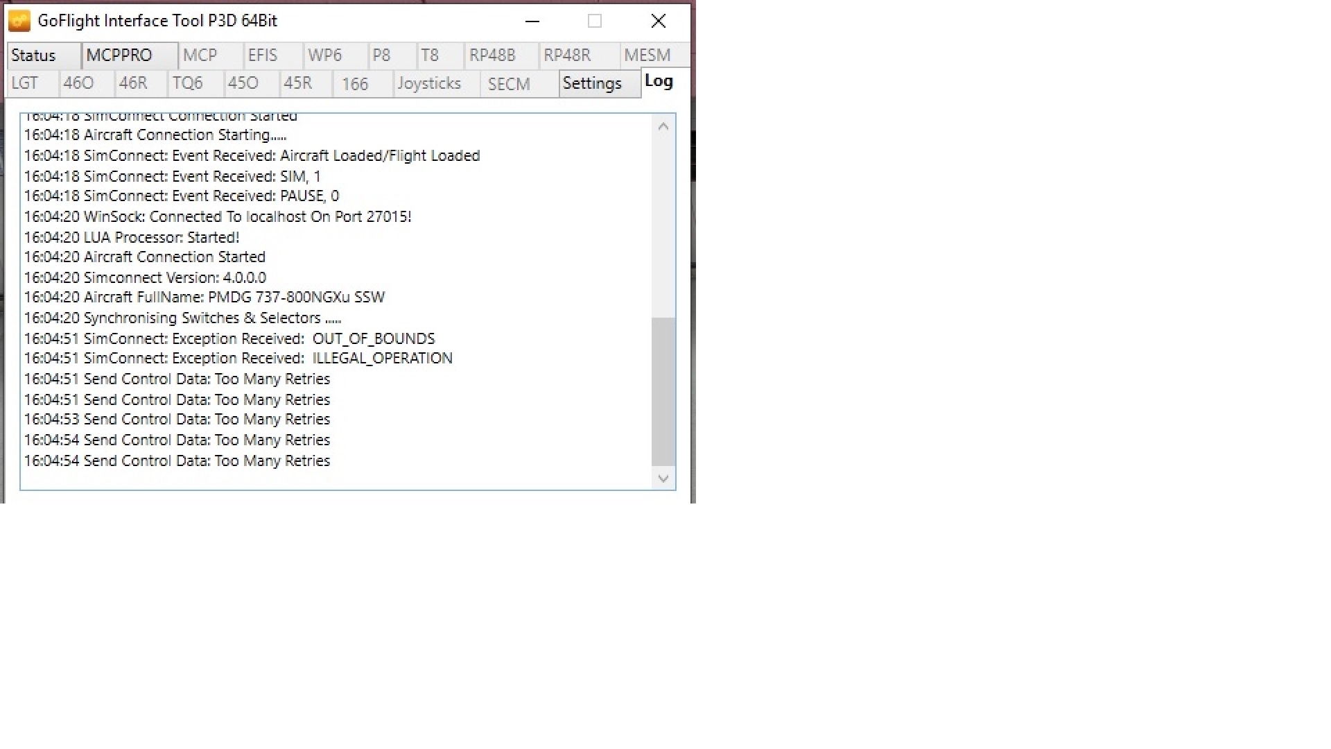

  • Here is a Jpeg of the log running
    Ben
