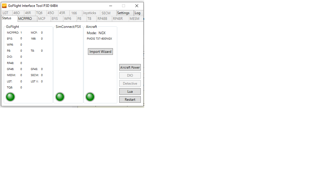

Hello,
i have a problem with my MCPPro with the GoFlight Interface Tool. After a Systemcrash the MCP will not work with my P3D.
After the a restart of my Computer the Softwar GoFlight Interface doesn't start, so ich have reinstall this Software. Now Goflight will start but it do not work with the p3d.Maybe the program can't connecting to 127.0.0.1:27015 see log

  • The NGX does not use Lua or Winsock so I suspect its something more serious. Can you roll back Windows to a restore point prior to the crash?
  • Hi Steve, i have roll back my windows to a restore point but it wasn't successful. In top of that i had reset my winsock catalog. Now the connection ist ok but your are right- that was not the problem. Do i need an importfile or something? Here ist current log - maybe you see more as me... thx for helping

  • You are now running the NGXu which only works with the 64Bit version of GIT.
  • Yes i use the 64 Bit version. Now i have deinstall and reinstall GIT P3Dv4 64Bit without a positvie result.
  • ... Now i have change the USB Slot and voila- it Works!! the Problem is solved
