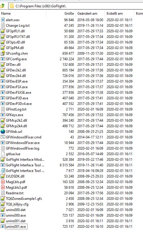

Is the key of GIT P3Dv4 also valid for the 64-bit version?
The instruments do not start automatically. There is also no security question when starting P3D. If I then start the GFDevP3Dv4.exe manually, the instruments work. But after about 5 minutes they turn off.
