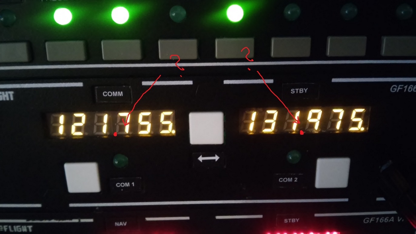

But I can not cope with the display of the comma in any way - I need it to be in the 3rd position (from the left), as shown in the photo:
I am asking for help, because I have already exhausted my own ideas ....

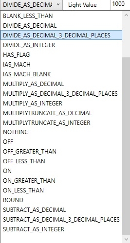

  • Use a Light Action DIVIDE_AS_DECIMAL with a custom value of 1000.

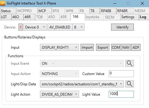

    I thought so too and of course I tried it too.
    But it doesn't work for me.

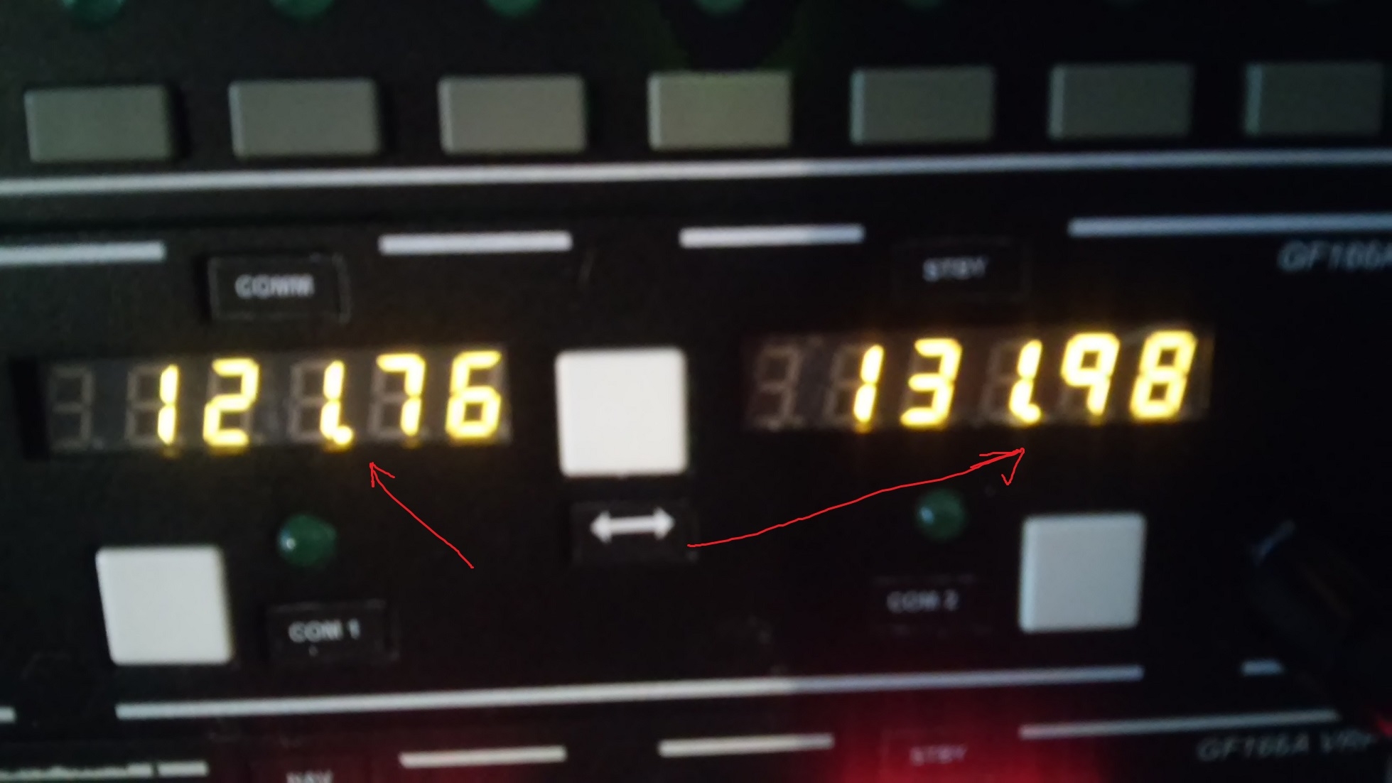

    Here's what I get then (sorry for the quality of the photo):
    Changing the value from 100 to 1000 does not change the position of the decimal point, but only the number of displayed digits.

    Unfortunately, I still can't set the frequency display with 3 decimal places despite choosing the option:
    DIVIDE_OF_DECIMAL_3_DECIMAL_PLACES.
    When he writes in the field next to 10 - the comma on tehe screen moves one place (XXXXX.X); when I enter 100, the comma moves two places (XXXX.XX).
    But when I enter 1000 - comma still remains unchanged; numbers in the format XXXX.XX or XXX.XX appear on the display.

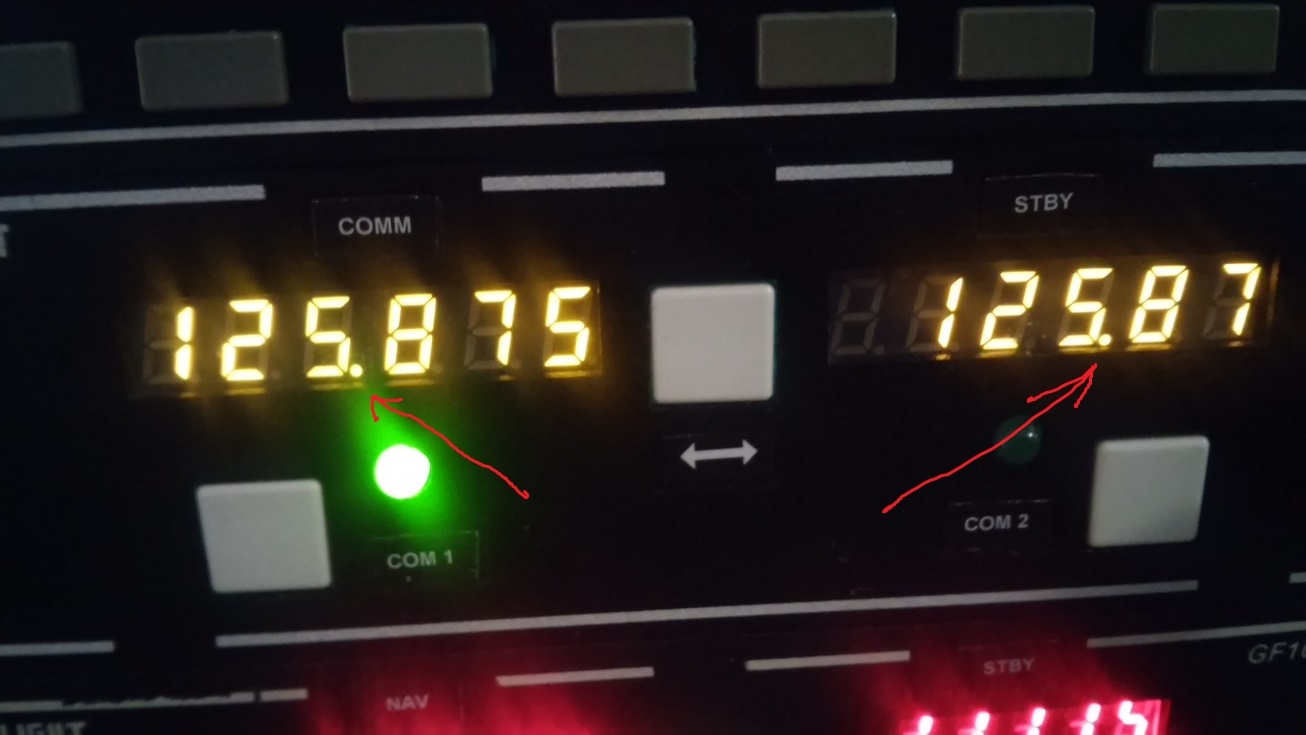

    The left display window works 100% correctly, but there are still problems with the right display. Still with "DIVIDE_AS_DECIMAL_3_DECIMAL_PLACES" and Light Value: "1000"
    the format for presenting the number is incorrect:

    After the last amendment, everything is OK.
    I really appreciate your work and thank you very, very, very much.
