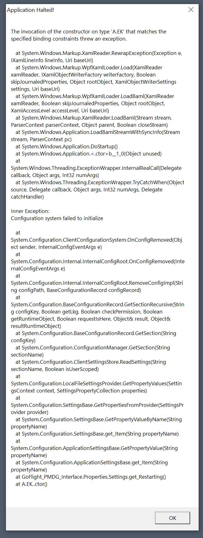

GIT Application halted
Hi
Using p3dv4 , all OK sunday , today this ?
Any fixes ?
Thanks in advance
  • An XML file is corrupt. Try deleting C:\Users\your username\AppData\Local\PollyPot_Software. If that doesn't work, open up the XML files in Documents\GoFlight Interface Tool and see if anything is in them and/or identify if something is odd at the beginning of the file (use Notepad++ and get it show all characters).
  • Hi Steve
    Tried the deleting of folder and retinstalled , the error message has gone , no the interface starts and then hangs
    ( see attached ) , it wont close unless I use the taskmanager
    The goflight gear all shows up Ok in its Golflight software .
    Any suggestions >?
    Thanks in advance.
    Adrian
  • No attachment?! Did you install GIT into the Goflight drivers directory as required.
