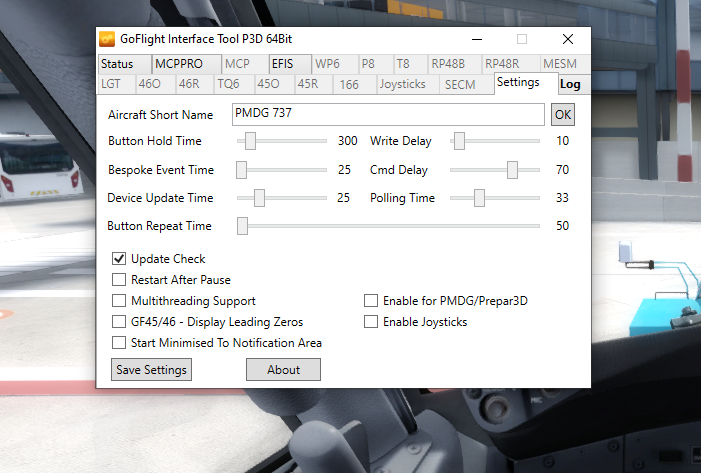

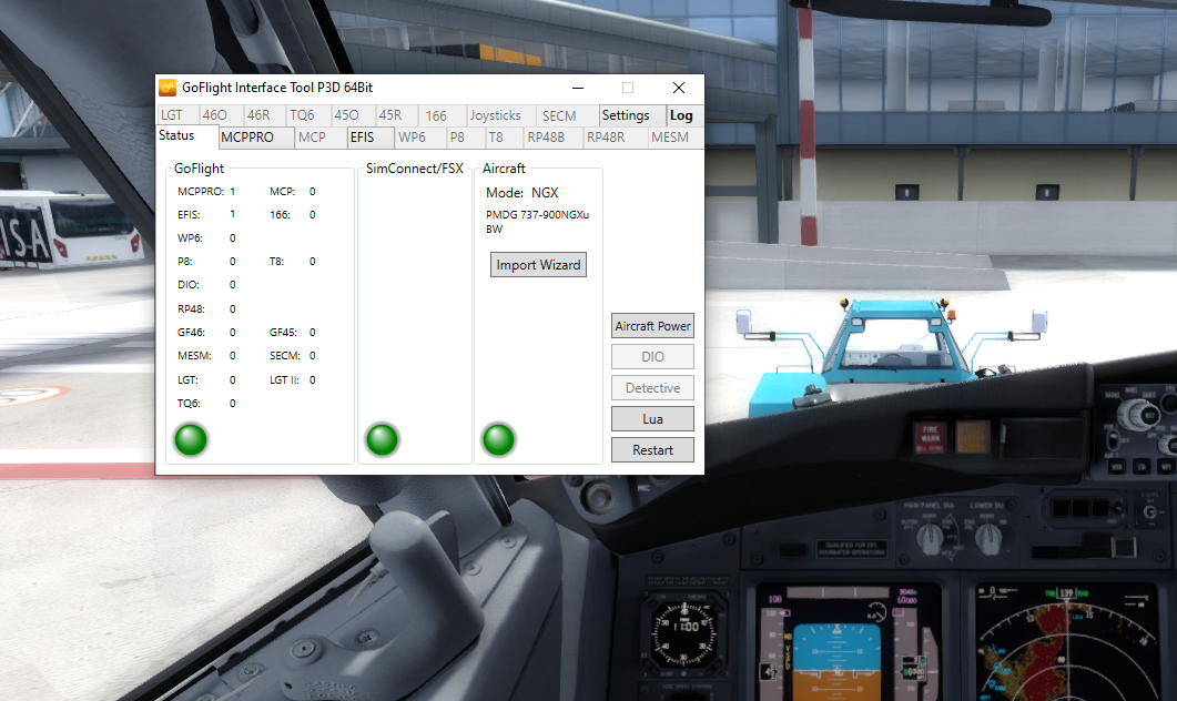

I have regularly installed Goflight and Goflightinterface in the same folder (Program Files (x86)/Goflight), but the MCPPRO hardware does not connect to the aircraft controls.

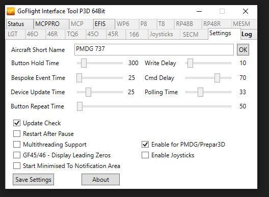

In the Goflight interface on which the 3 LEDs are green, in the setting I tried to both tick and remove the check mark for ENABLE FOR PMDG / PREPAR3D.
On the MCPPRO, in the various boxes (route, ias / mach, etc.), there are always the dashes --- ---- --- and not the numbers visible on the panel of the plane.
What's wrong?
Can someone help me?
Thank you
Enzo47
See the FAQ entry "My MCP PRO or MCP Advanced is not updating its display (just showing zeroes or dashes)" here: https://www.pollypotsoftware.org.uk/support/user-guide/user-guide-git/16-installation/70-faq-goflight-interface-tool.html
