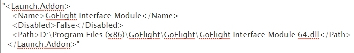

I can try your suggestion above, the contents of my luaconfig.txt files are:
hostname: localhost
port: 27015
path: default
luatimeout: 500
luahookcount: 3
Where would I paste my IP address to?
