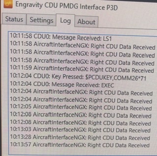

Hi , since I downloaded Pmdg 737 NGXU , The exec light stop working physically on the Engravity CDU (first model )
But only in NGXU . Original PMDG 737 NGX works ok . So we can discard setup , anyway :

The attachment below is an example of a direct command ....
No exec light was present on the CDU.
