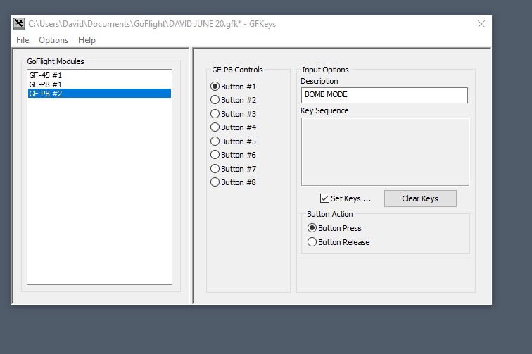

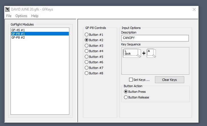

    I enclose two screenshots of the config panel for keypresses program by G.Flight:
    1. Is the normal format with key presses that were programmed shown clearly in their two boxes which will be operated when that button is pressed.
    2. Is the current format shown when you try to change a keypress from a previous one or start a new one there is no box or boxes to see in which to do it.

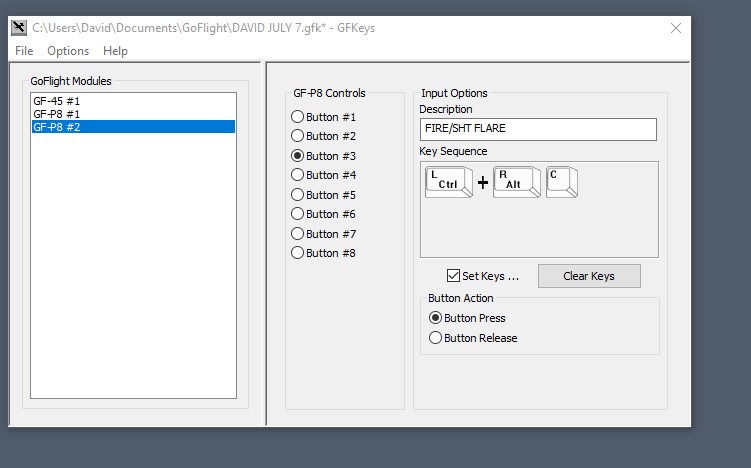

    There is one thing that puzzles me and the following sequence of button presses was used to do a function as default in the program and i don't remember having any difficulty before in Windows 7 ..Rt Alt+ C now this is not possible to program as the keypress program inserts L Cntrl as well regardless of how you press the keys to set it up. I have gotten around this by using another unused sequence of key combinations but I am sure I did not have this problem before. Is it a windows 10 thing or a Go Flight thing, please.
