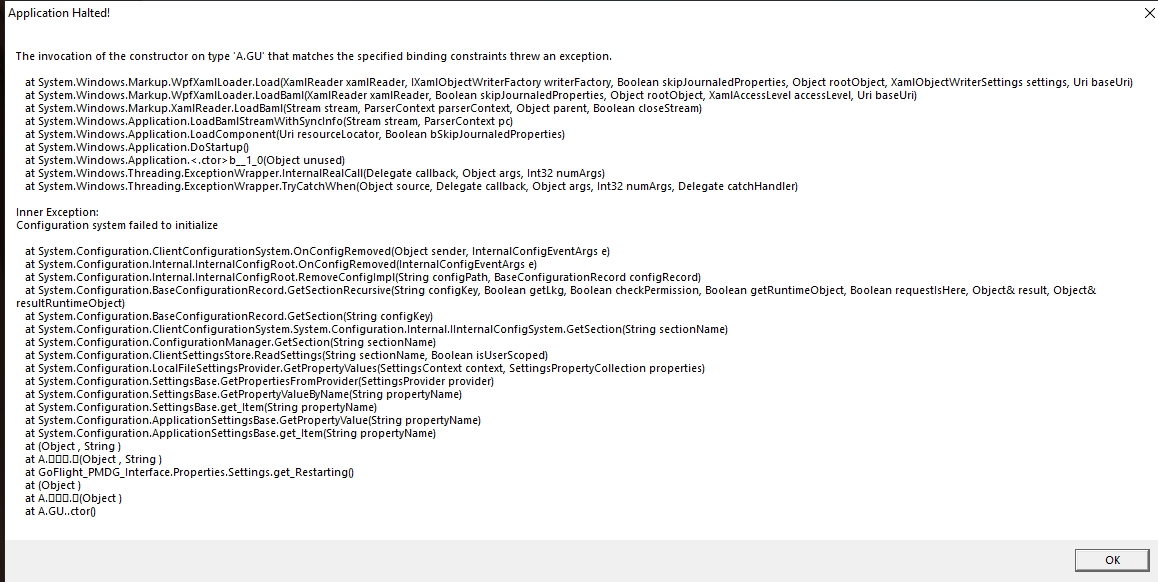

Running XP 11.51b1 and flying for about 20 mins. Either XP or the GF interface tool locked up on me. Had to shutdown to correct the lockup. Started everything back up but when trying to run the GF interface tool it crashes. I have uninstalled GF, defaulted and same issue each time, any aircraft I try to use it on.
I do have the MSFS2020 version and that version works fine and loads for MSFS
C:\Users\xxxxxxx\AppData\Local\PollyPot_Software
