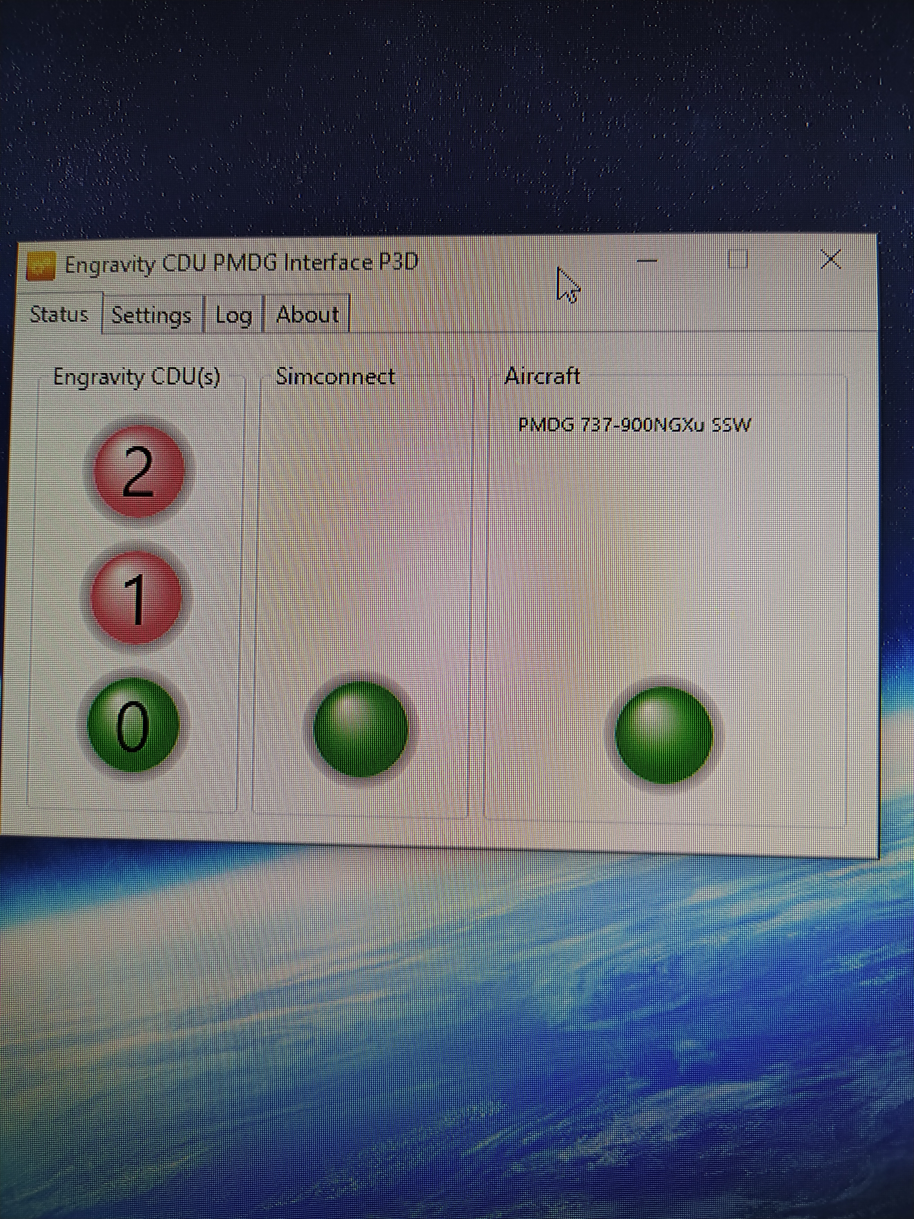

I just bought the software and was super exited to try out my CDU. I followed the instructions but I have simply a blank screen. It wasn't really clear which version I have to install in the manual so I decided to go with the latest one "EngravityCDUPMDGInterface_Setup_2_0_5_0"

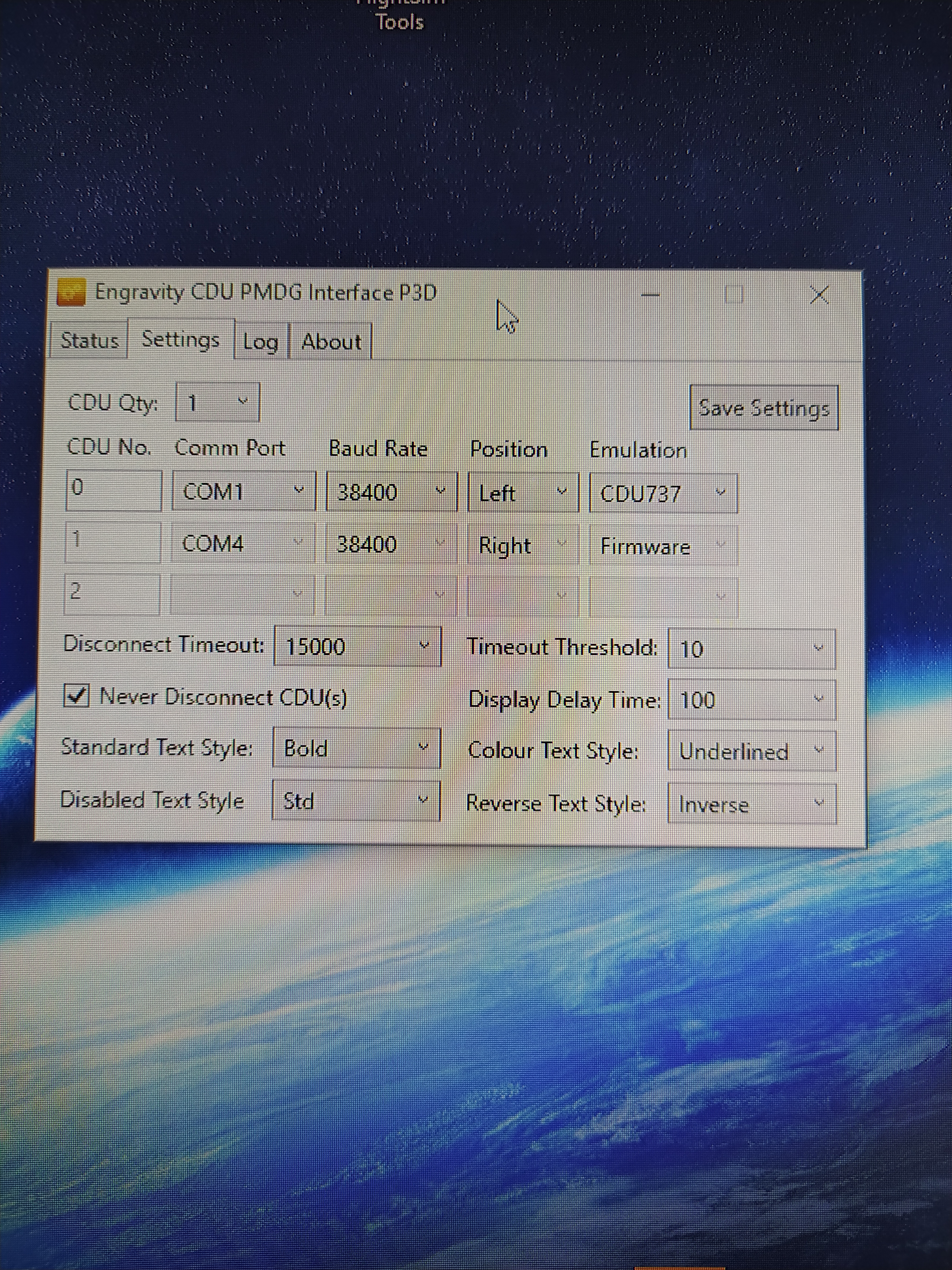

I put in all the information Baudrate etc. but the CDU won't display anything and no buttons are pressed in the sim when I press a button on the CDU. Can someone please help me? What did I do wrong?

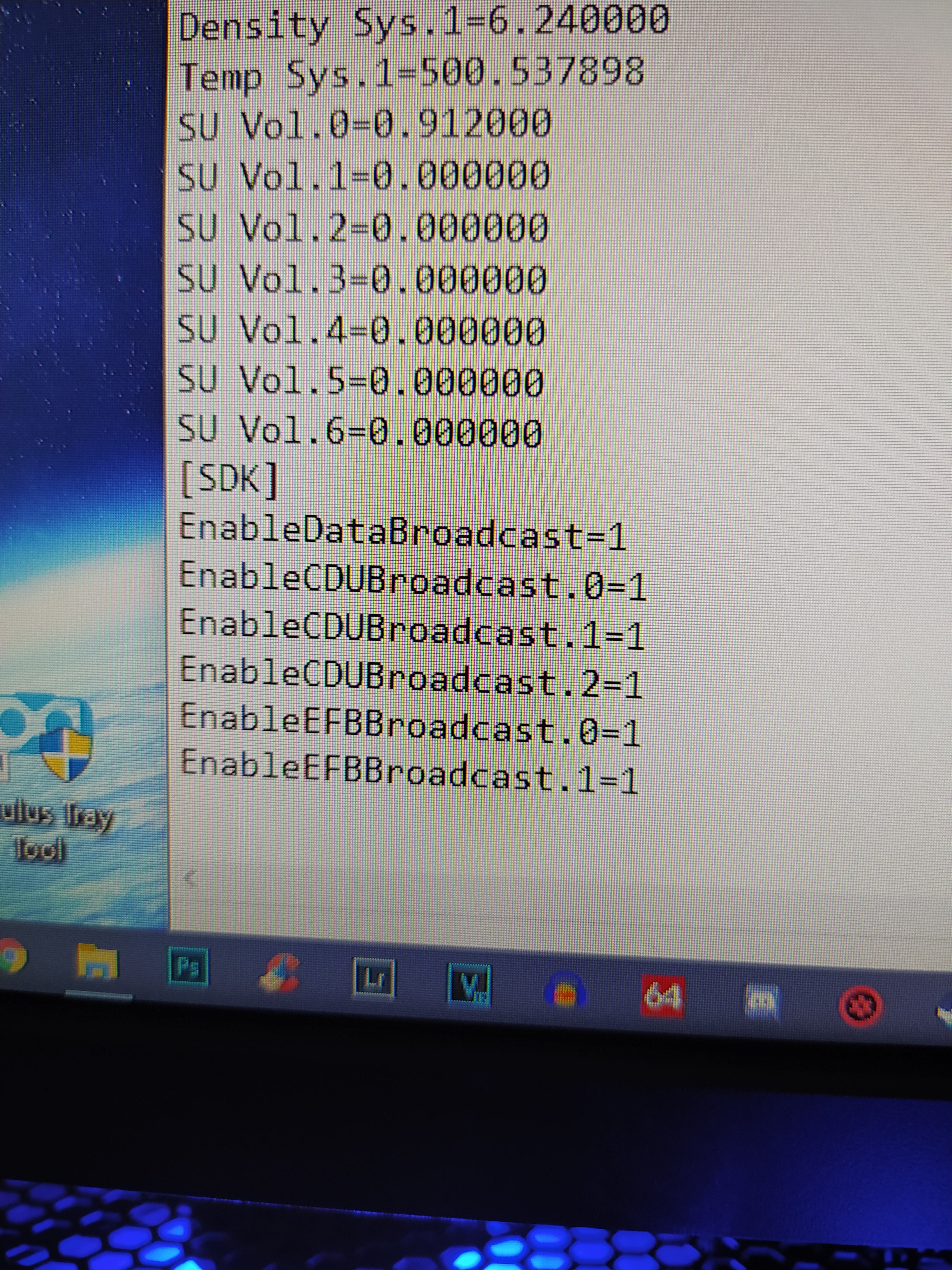

    2:38:54 Aircraft: PMDG EnableDataBroadcast SDK option is OK in Prepar3D v5
    2:38:54 Aircraft: PMDG SDK option is OK in Prepar3D v5

    I am running the latest version of the 737NGXu
    The aircraft is sending data and I don't have the 737 as default startup scenario. It's the F35 and then I change to the 737

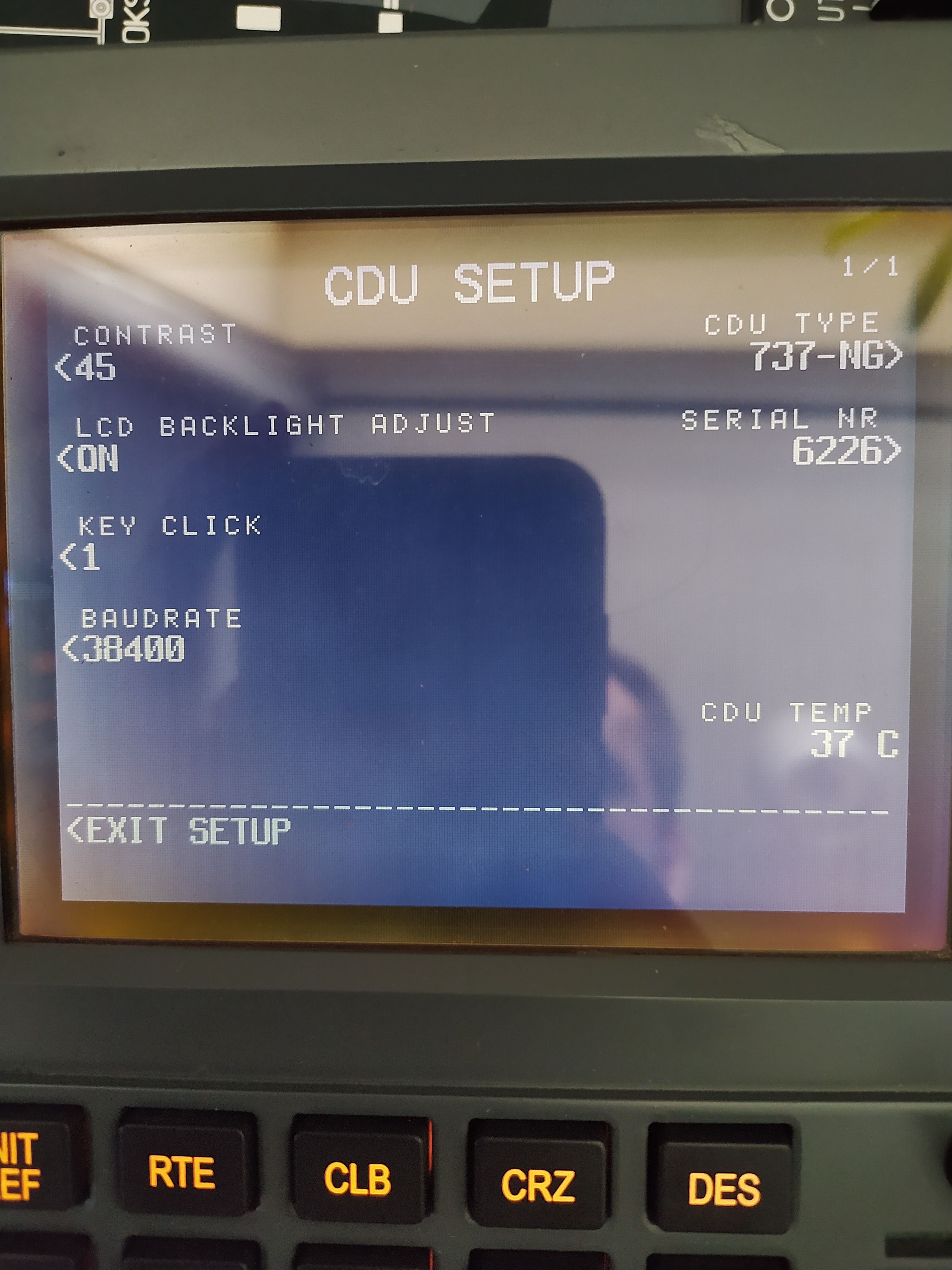

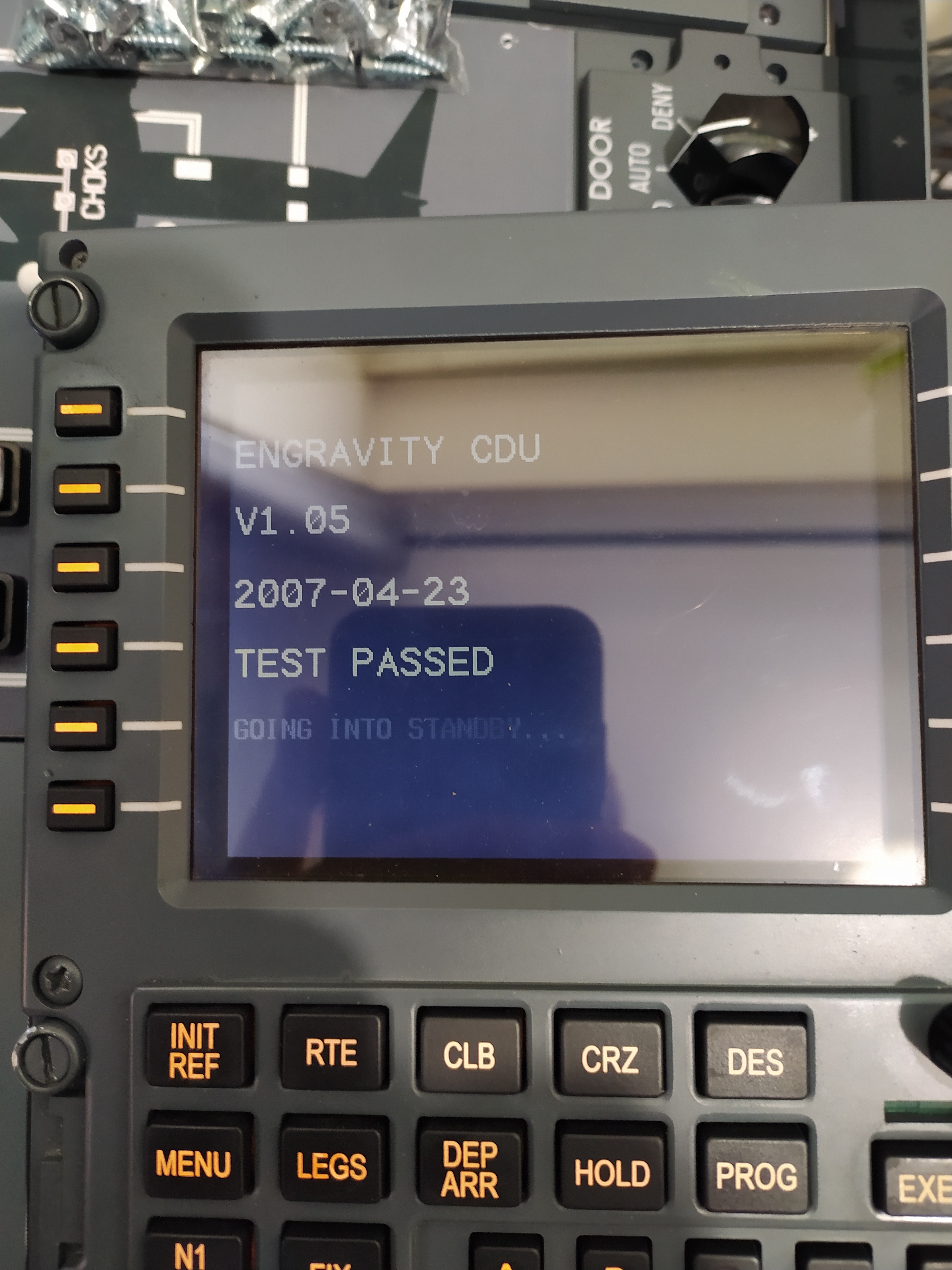

  • From the picture it looks like you have the wrong CDU which it won't work with, is it the newer version?
  • No it's the old 1.05 one which should be supported if I haven't misread that?
  • The version 1 CDU is not supported if that's what you have, which I suspect you do because the screen colour looks wrong compared to mine, which is green coloured.

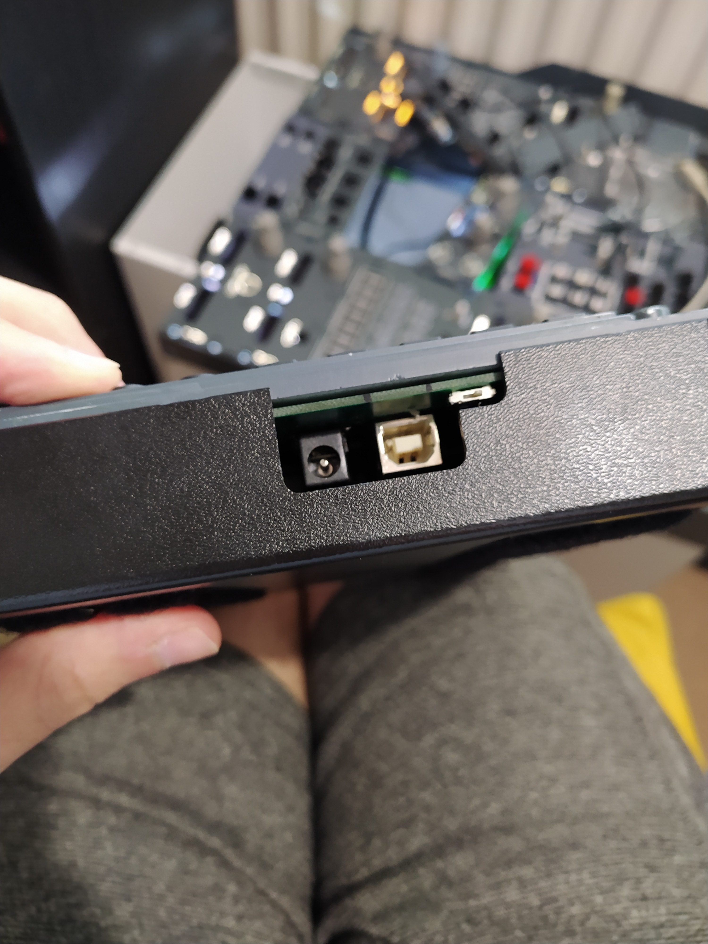

  • Do you have the 737 or 747 CDU? Usually only the 747 CDUs are green and I have the 737 CDU. The system requirements say
    "Fly Engravity CDU (Model 737 [Non-Colour Version] or 747). ... The version 1 CDU with the VGA & USB interface and the new Colour CDU are not supported."
    I do not have the version with USB and VGA. It's only USB and the screen is not the coloured one. To me that sounds that my CDU should be supported as it matches the requirements. Correct me if I'm wrong though :)

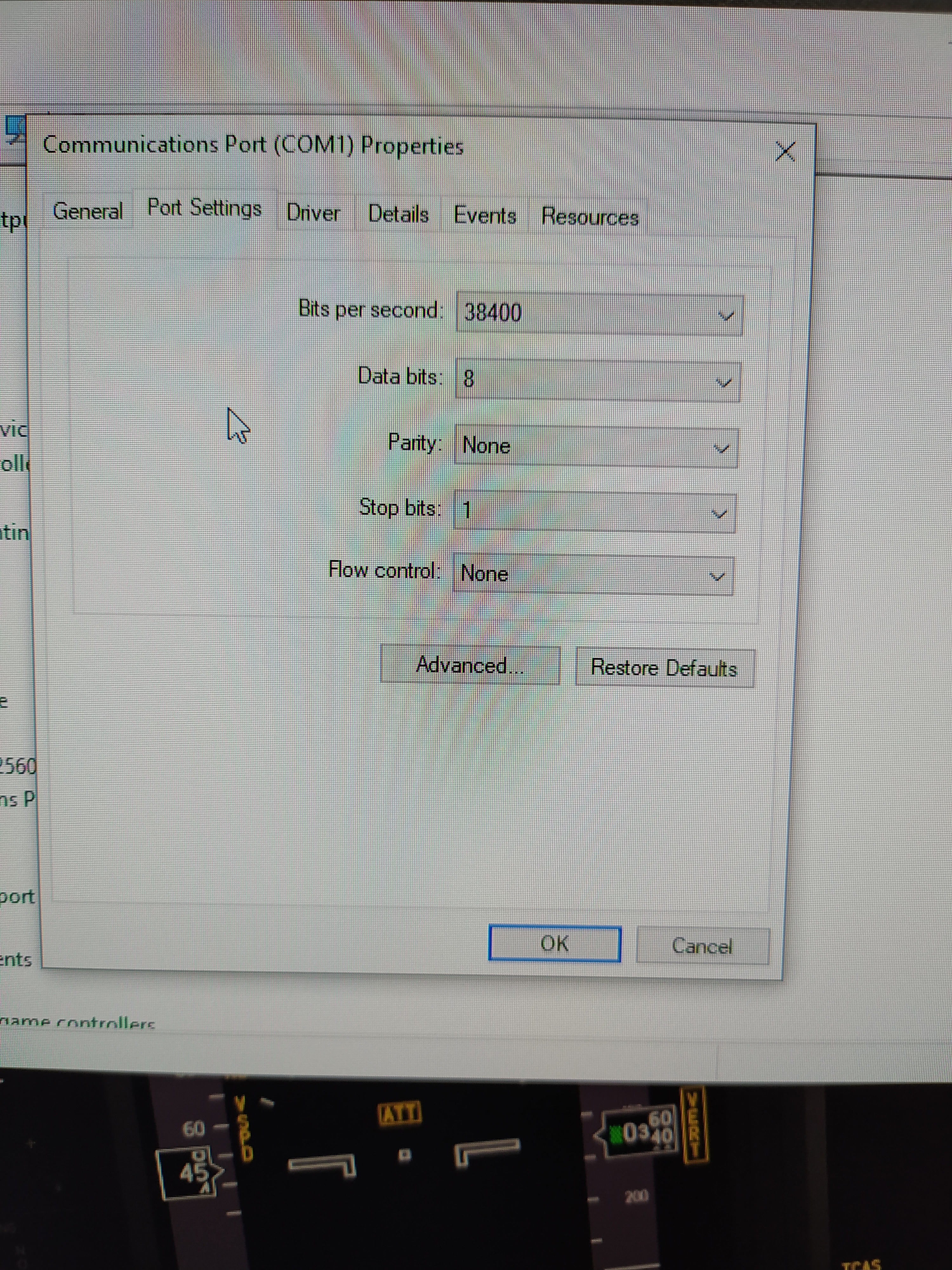

    My bad then, I have the 747 version. You don't have a physical COM 1 port on the PC do you? It may be worth using something higher in case their is a clash. Say COM5.
    The keys should always work, which makes me think its a communication problem.

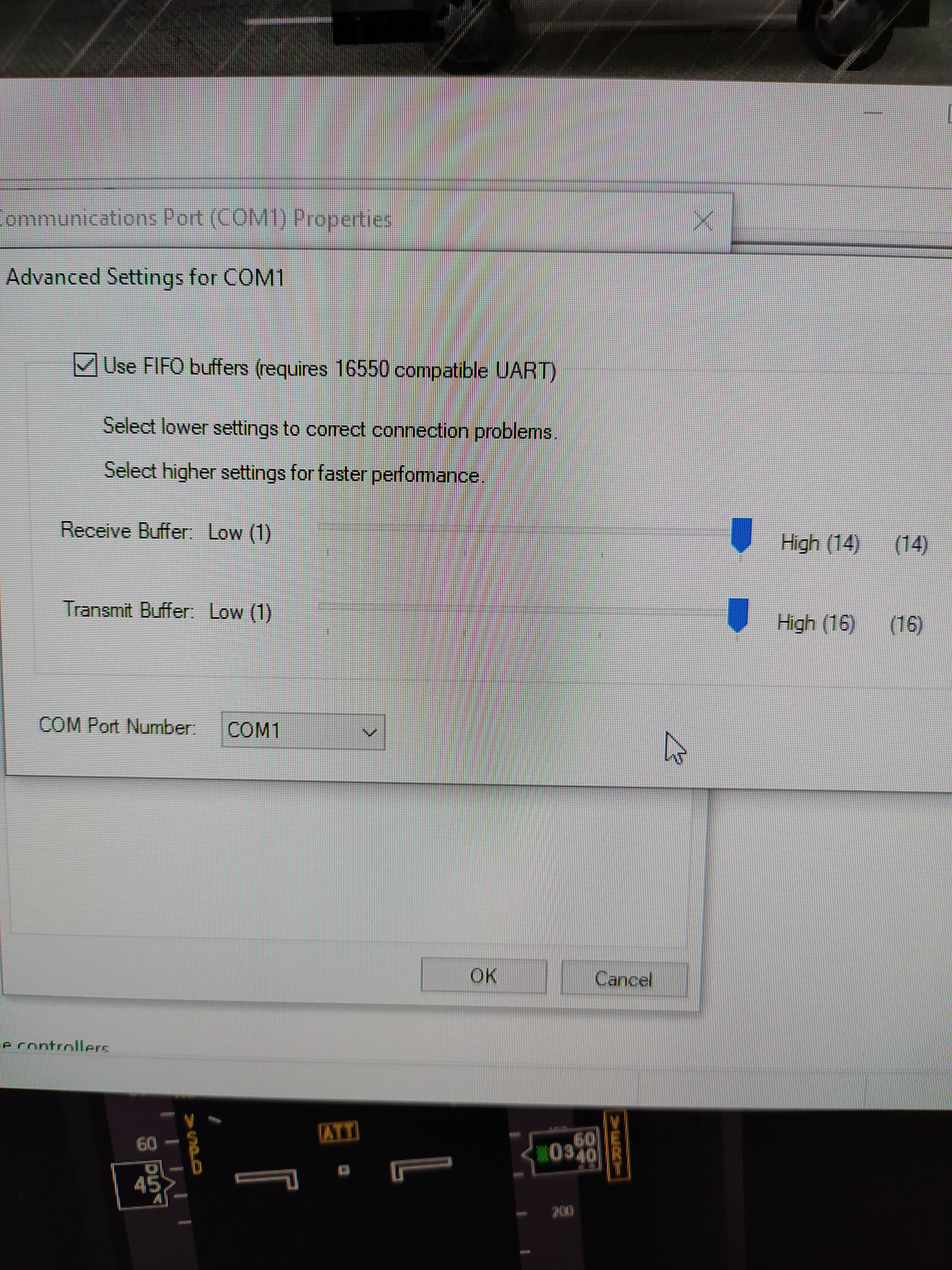

  • I tried every port until 20 ... Can you please confirm my installation is correct? What else could be the problem?

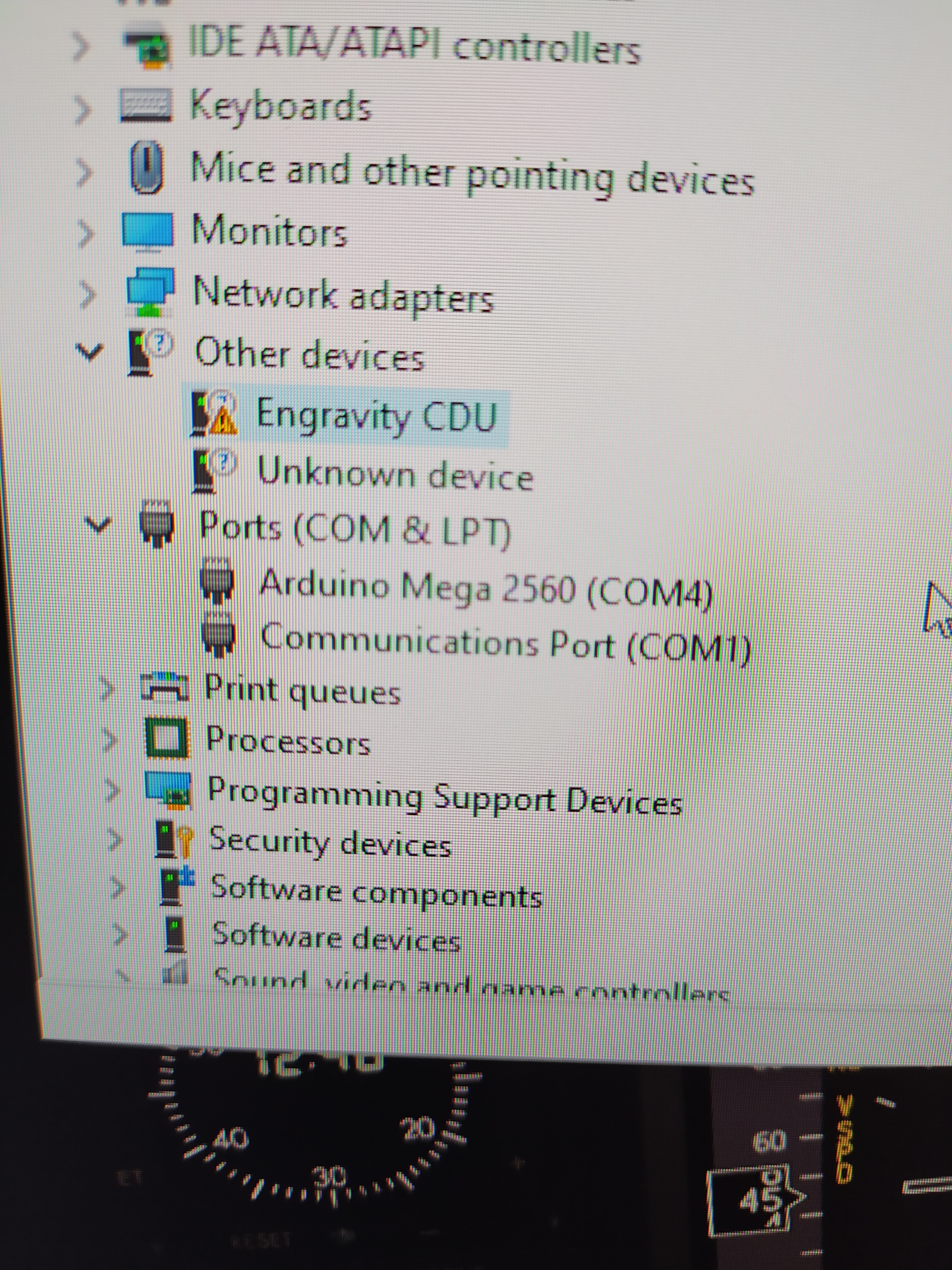

  • Hey Steve,
    Well, I finally figured it out myself. In the manual I was reading that the device manager would display Silicon Labs CP210x USB to UART Bridge. In one of my screenshots you can see that I was missing that entry and since you haven't mentioned it I thought everything must be fine or the Silicon thing was just something from older versions.
    I simply checked all drivers and there it was - drivers got updated and I now see the Silicon thing. Just had a test run and everything is working fine now.

    My CDU version is 0.06 and I am running P3D5 within Win10. I load up the 64-bit Engravity CDU PMDG interface and get the three greens on the status tab (COM 1 port selected). The CDU boots up satisfactorily, passes test, before going to standby as expected.
    Unfortunately, that's as far as I get; upon loading a PMDG airliner, there is nothing happening with the CDU unit.
