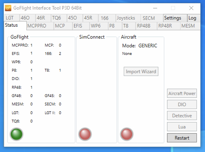

My Goflight Interface Tool P3D 64bit software seems to have thrown a wobbly overnight it was working fine yesterday but today its seems to hang itself when i load prepar3d and the PMDG 737 aircraft now and none of my goflight devices are working with it anymore i have attached the log to see if it sheds any light on whats going on.
All my devices are showing in the interface tool fine.?
Any help would be appreciated as I'm pulling my hair out as to what's happened

Thanks for the info butI think I'm screwed as my BespokeEvents, BespokeVariables & PMDG are all empty in both GIT directory and backup
What I can't understand is why the backup directory is the exact same as the root directory what's the point of having a backup directory if the main one writes over it with a corrupt one.
Now I'm back to the tedious task of processing this all this back in manually, when I get it done I will back it up and move it elsewhere in future so it can't be written over.
