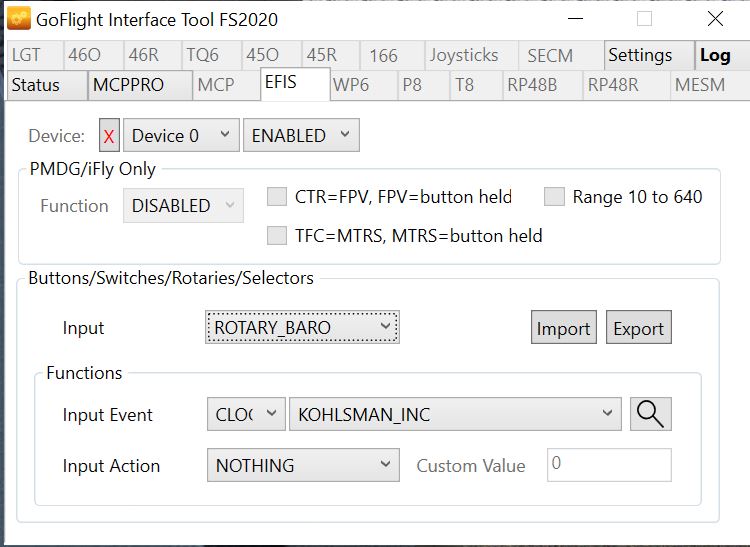

How to setup Kohlman event to a rotary knob
I´m struggling to get the Kohlman event to work with a rotary knob in A32NX with the Goflight efis. On detective, I just find the event "Kohlman Set" and choosing that, the QNH value does not change in increments or decrements but at once. Any of you can give me some guidance to have it working properly.

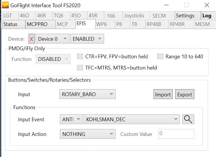

On the FBW A320NX don't use the Detective for the EFIS baro knob, as it does not need a bespoke event. You just assign an LVAR to the knob direction (clockwise/anticlockwise).
Instead, just go to GIT, select and enable the EFIS, select Rotary Baro, and use KOHLSMAN_INC for Clockwise and KOHLSMAN_DEC for Anticlockwise.
See attached pictures.
