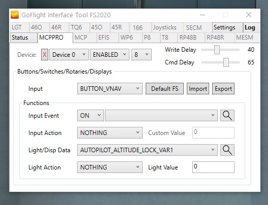

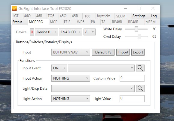

  • I appreciate your help. I spent some time trying to make the change suggested but was not successful. I cannot find AUTOPILOT_ALTITUDE_LOCK_VAR:1 under the MCP Pro tab. I tried uninstalling and reinstalling GIT and the module, but am now back to having a totally blank MCP.
    Attached is a screen shot of the MCP pro tab, and the GIT log.

  • Click Defaut FS to get the default settings back. Then select the Input for the altitude display and then change the Light/Disp Data variable to AUTOPILOT_ALTITUDE_LOCK_VAR:1
  • OK, I am back to where I was before - MCP Pro working except for altitude rotary. Followed the changes you suggested but no success. I should mention that I also have a Bravo throttle quadrant and the altitude selector on the Bravo give the same result as the MCP; ie does not change the altitude value in the aircraft.

  • There are a number of AUTOPILOT_ALTITUDE_LOCK_VAR's e.g. AUTOPILOT_ALTITUDE_LOCK_VAR:2, AUTOPILOT_ALTITUDE_LOCK_VAR:3 etc. Try at least the first few, one of them will probably work.

  • I do have the WASM module in Community folder. I have tried all AUTOPILOT_ALTITUDE_LOCK_VAR options 0 thru 8 or 9 without change. Recent log is attached.
