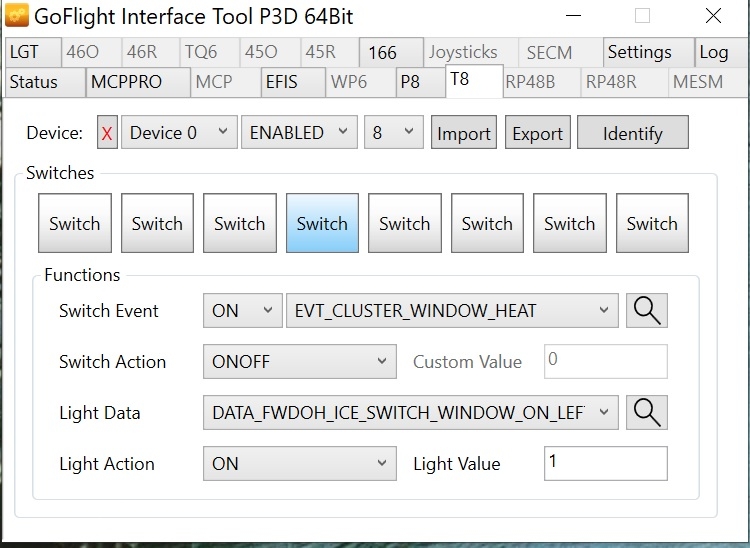

I'm attaching a screenshot of the command assigned to the T8 switch. Below is the entry in PMDG737.xml. Does that look okay?
Ray (Cheshire, England)
Control ID="3" EVENTType="NGXEvent" EVENT="EVT_CLUSTER_WINDOW_HEAT" ACTIONType="EventCmd" ACTION="ONOFF" LIGHTType="NGXData" LIGHT="DATA_FWDOH_ICE_SWITCH_WINDOW_ON_LEFT_SIDE" LIGHTACTIONType="LightCmd" LIGHTACTION="ON" LIGHTVALUEType="Float" LIGHTVALUE="1" /

I’m at a loss why it works for you but not for me. Just to confirm it’s P3Dv5.3 I’m running. Hopefully this and the earlier info will show where the problem lies.

I have just confirmed in sim that only the window heat is going on and off in my test. I am using MOUSELEFT_WITH_OFF as the action, but I don't think that would have any impact.
You don't have something assigned in FSUIPC or some other product that is responding to the switch? It might be worth unassigning the event in GIT and see if the problem remains.

The deice commands were being actioned twice, once by GIT and once by FSUIPC.
I’d been using the really helpful guide by Paul Henty here and overlooked the possibility of a clash with GIT.
