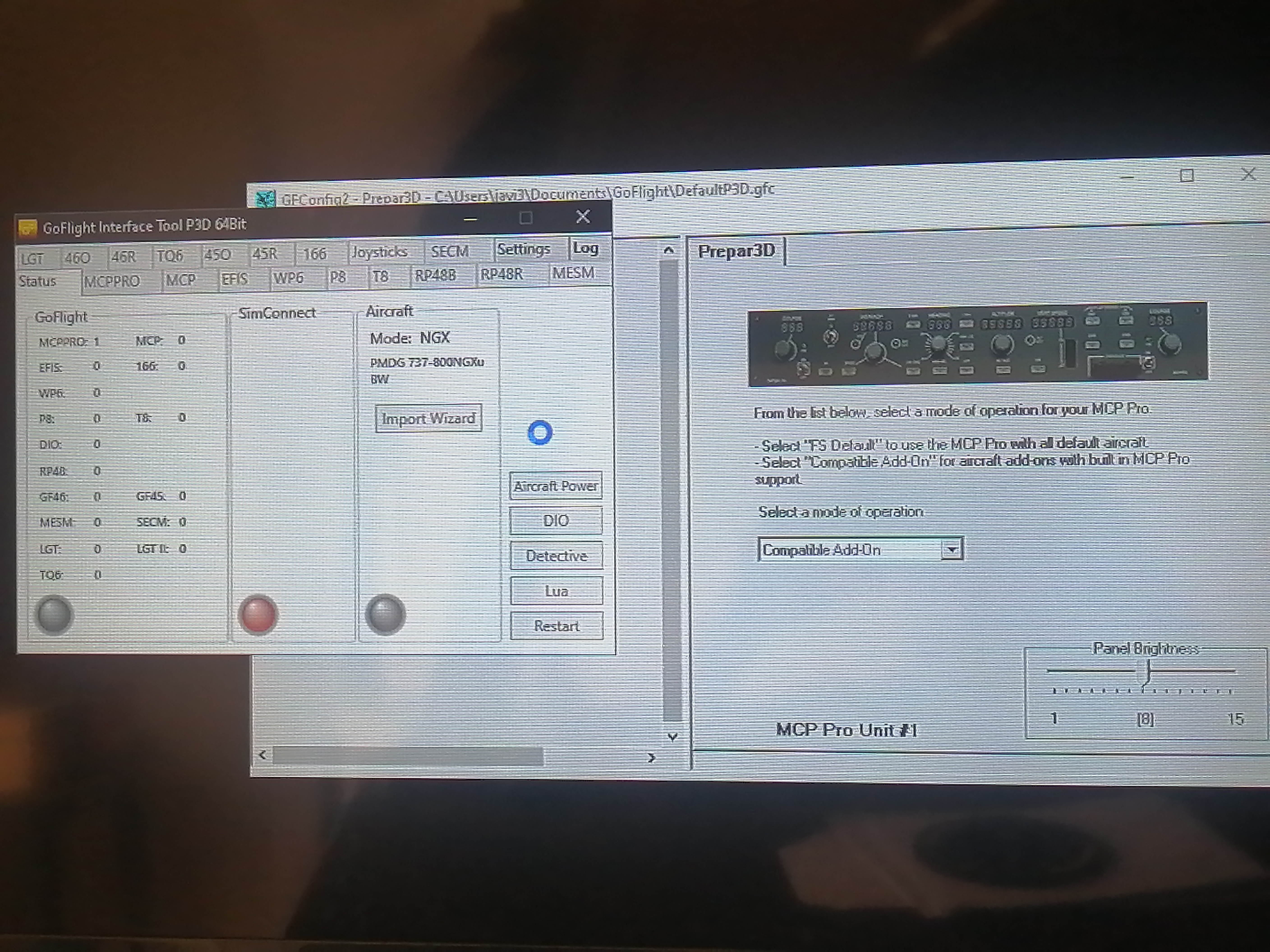

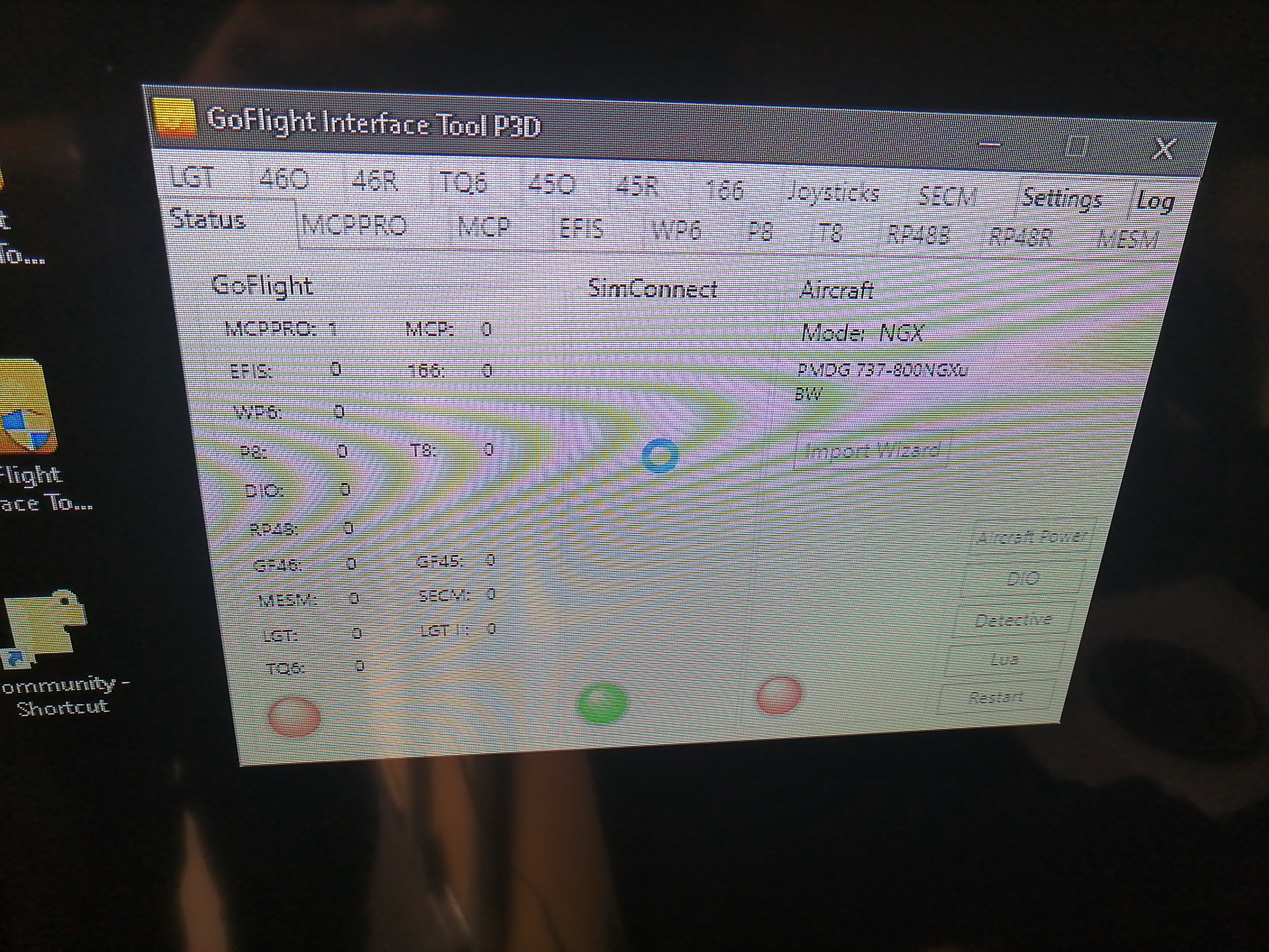

It was working fine. All of a sudden it stopped working. Any ideas?. I reinstalled. Changed USB ports, read Many of the trheads un the fórum. The status tan says mcppro:1. But the mcppro tab it's not accesible . Can't get to the log tab it freezes.
P3D v5 pmdg 737 ngxu Windows 10 64 bits.
Any help would ve appreciated.

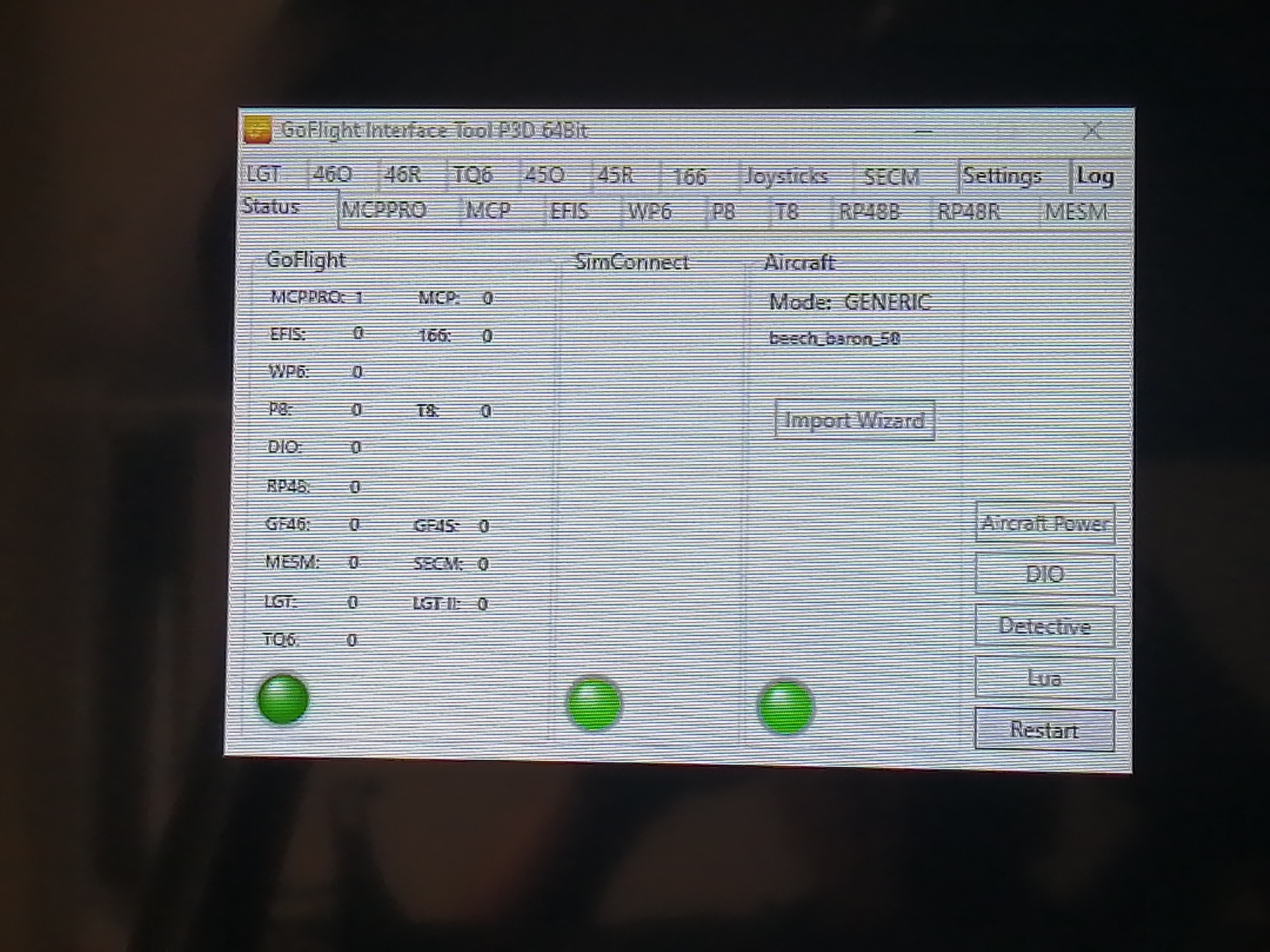

I can get it to work only with cfconfig.exe with default aircraft bit nota with pmdg 737.

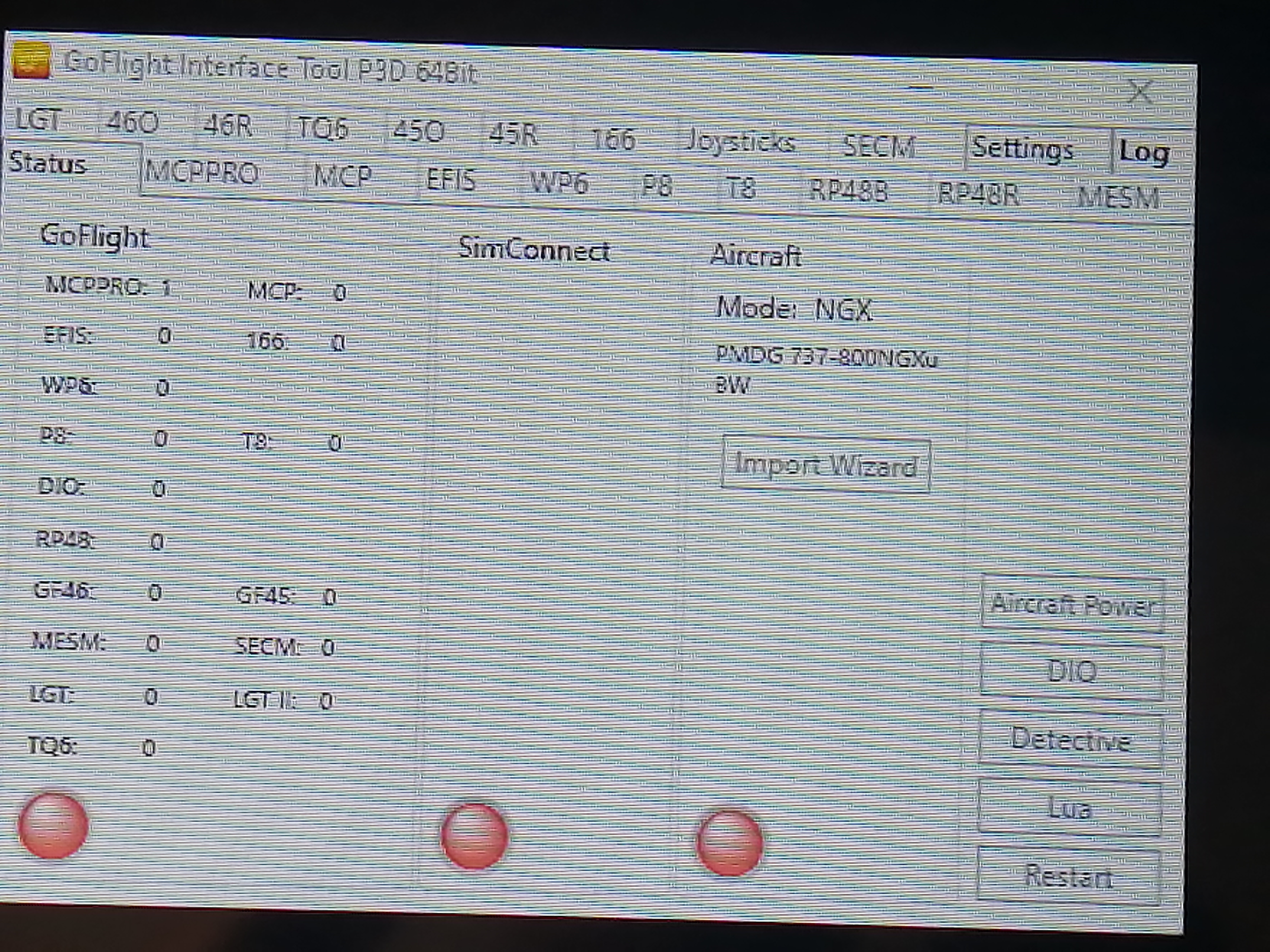

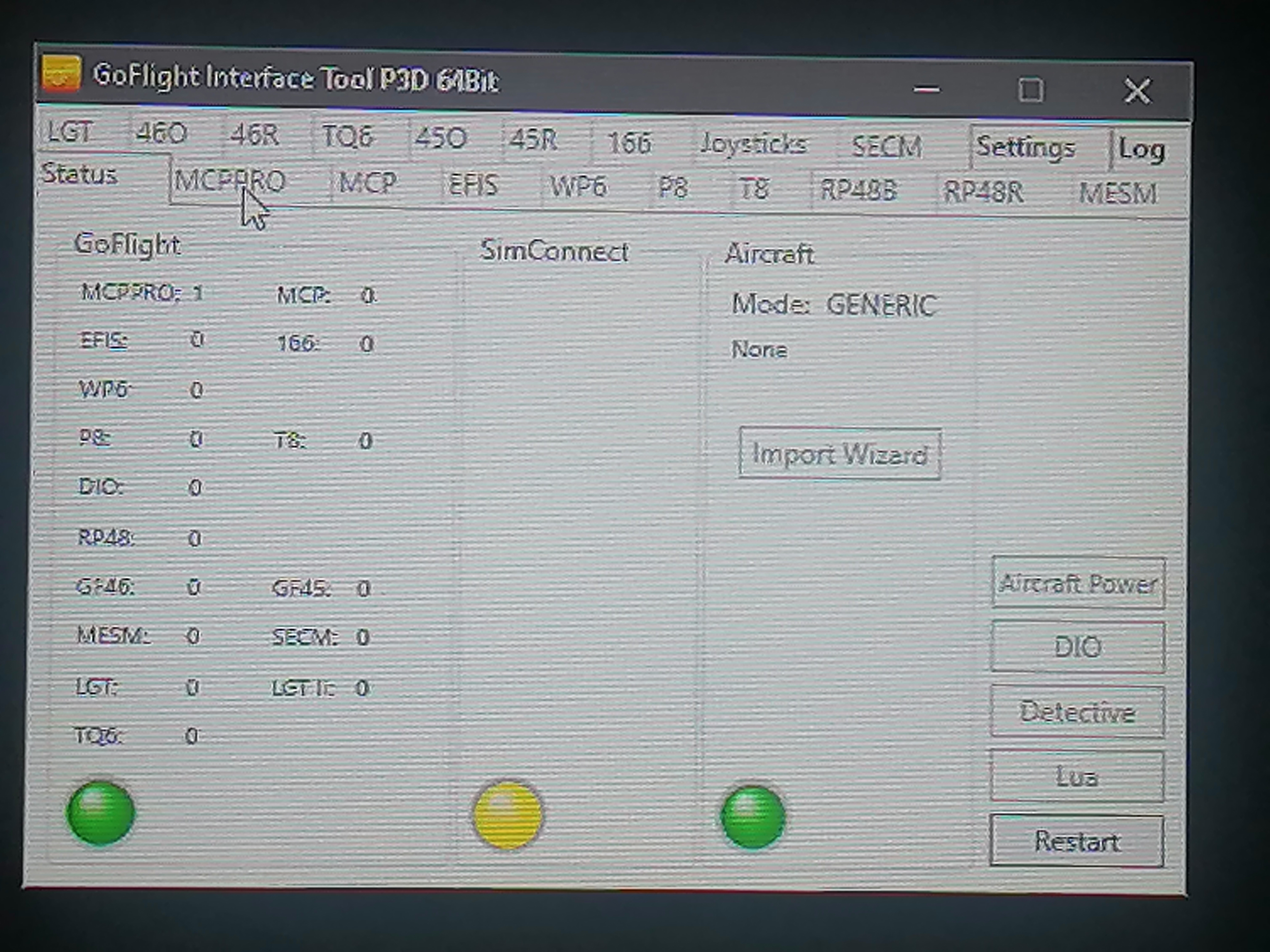

Same thing with 32 bit. The thing Is for the mcp to work I have to manually open gfdevp3dv4.exe from the goflight folder. When I try to do that with pmdg 737 GIT freezes. In both cases there's no MCPPRO Tab.
Sorry about the quality of the pictures. I hope this helps You help me. 😞

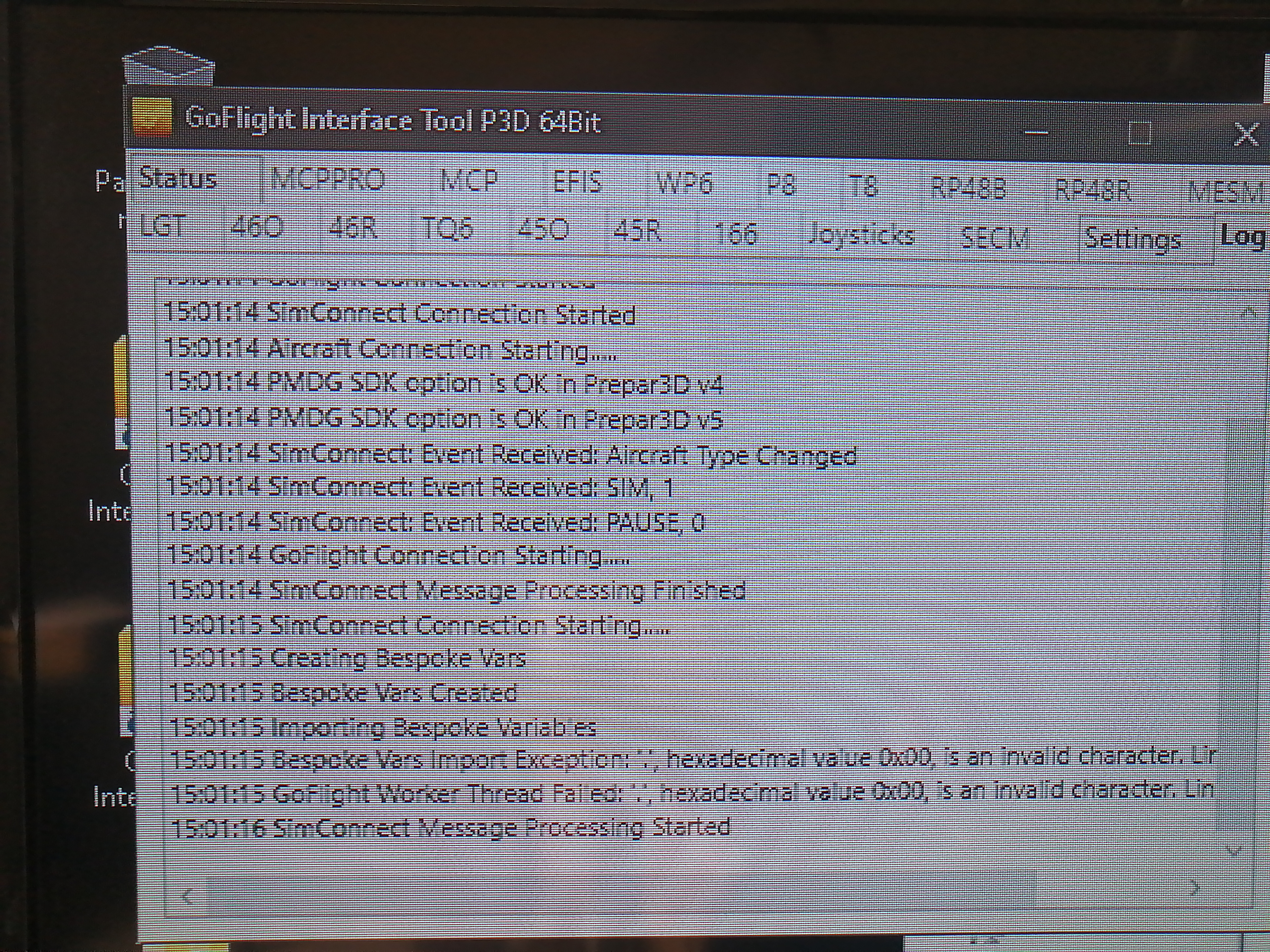

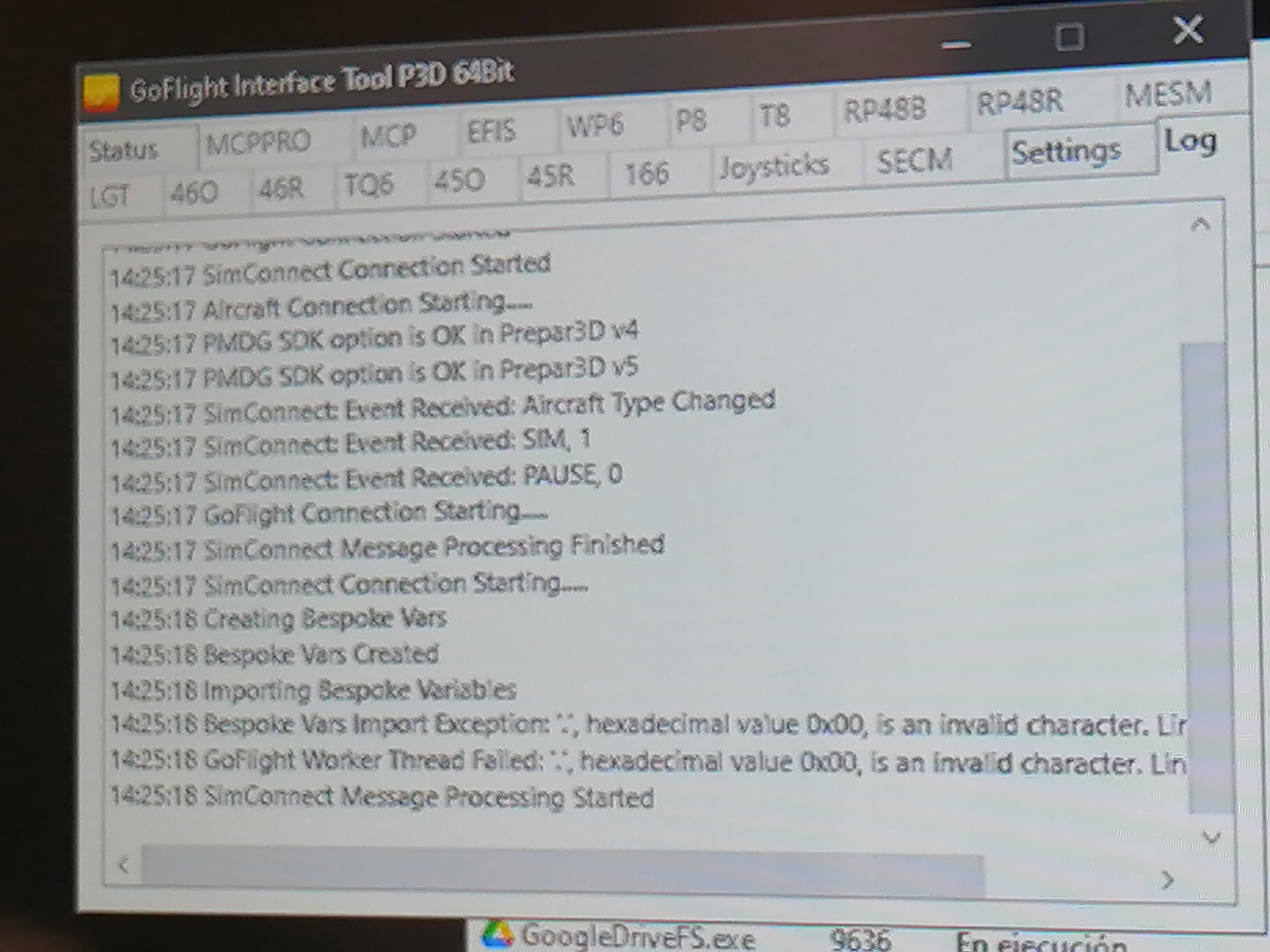

Managed to hit log before it froze.
Again sorry for the quality.
