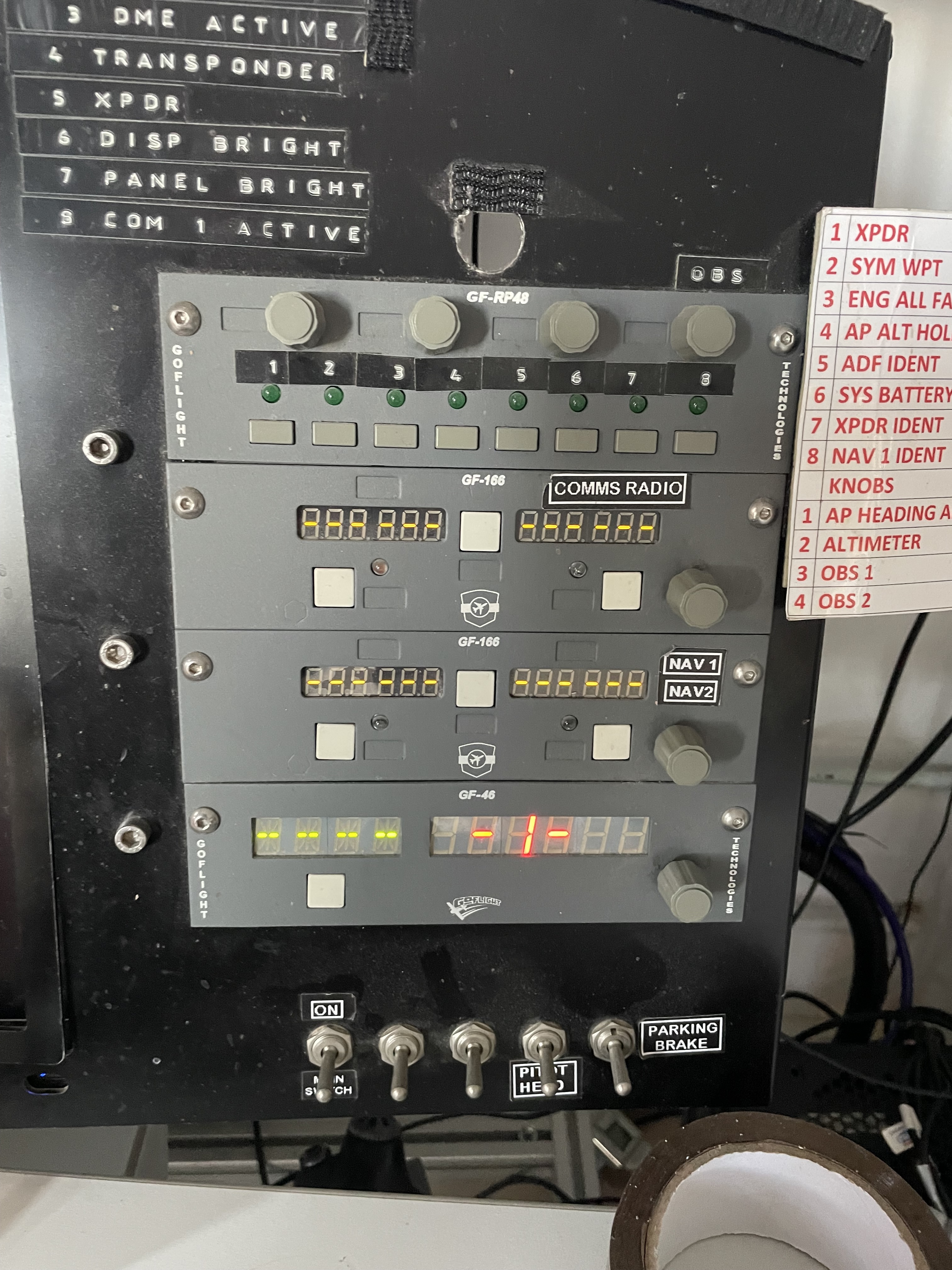

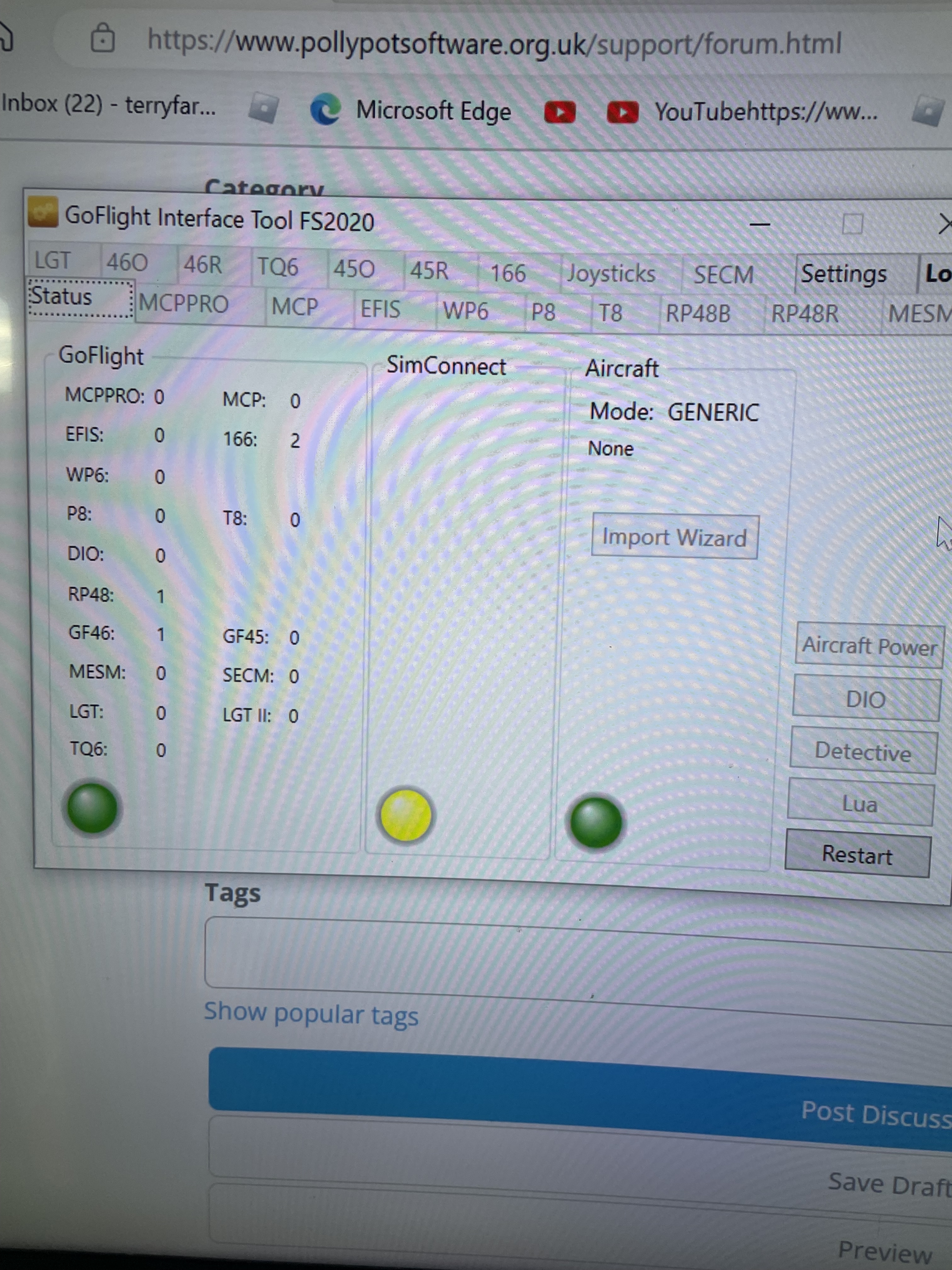

When I start the GF config tool 3 out of my 4 goflight panels light up, the GF RP48 will not light up and the other 3 GF166 and GF46 light up but have no data on them.
3 green light come on the GIT but then drop down to 2 and the goflight modules will not show any data when I have MSFS 2020 running with GIT, very frustrating.
Can someone please help me. Please find attached some photos.

    Have you configured the devices in GIT? (See this overview https://www.pollypotsoftware.org.uk/vanillaforums/discussion/1436/fs2020-feature-status-and-usage/p1). Can you also post your GIT log.

  • The GF166 and GF46 can be auto configured by clicking one of the relevant buttons on their respective GIT tabs as described in the link from my previous post.

    As for the GF166, I need more information. Does the identify button light it up?
  • Remember I have 2 166 but only device 0 can be enabled and identified, the other 166 should be device 1 but is not showing up.
  • Ok, then there is a hardware fault. Is the unit faulty? Is the USB cable OK? Is the hub/USB port enabled and functioning OK? Have you tried a different USB port?
