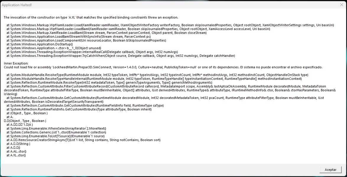

when I launch the program, I get an error and the program doesn't start. Just below an image of the error. can anyone give a light?
My GIT version is 4.7.3.2 and goflight drivers just downloaded from your site. I've Prepar3d v3.

  • Did you install GIT P3D.zip and not the other versions?
  • Hello,
    I used this you can see in the pic.
    regards

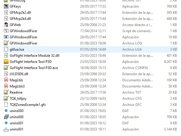

  • Can you confirm the file LockheedMartin.Prepar3D.SimConnect.dll is in your GIT installation directory? If it isn't, then there must be an error in the install program that I will need to fix. The file is attached for you to unzip if it isn't present.
  • Hello,
    the file isn't in the folder as you can see in the next pic.
    After install the file you posted in the folder GIT runs properly.
