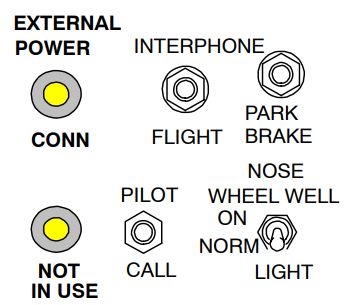

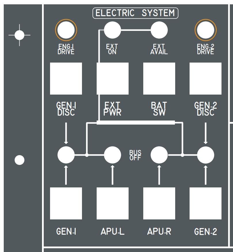

  • Hi Steve, thank your for your fast respond, unfortunately the DATA_FWDOH_ELEC_LIGHT_GROUND_POWER is only the equivalent to 7X7X_Ground_Power_Light_Connected, the other 7X7X_Ground_Power_Light_NotInUse has no Lvar in PMDG SDK. It's technically the information for the ground crew to not disconnect External Power Connector when in use (or disconnect when not in use) and as far as I can see the only possibility to make a Status Statement "External Power In Use". Or with the help of various variables and functions (if, then, else...) but then I need the help of the detective. See attached files of external connector and the overlay for my intentions, maybe you have an idea, how to proceed in this case... Best regards Ralf

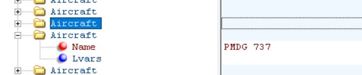

  • If the 7X7X.... variables are genuine lvars then it could be they have just not been created by the aircraft at the point of testing. You can manually add them to the PMDG 737 aircraft section of the KnownLvars.xml file in Documents\GoFlight Interface Tool and see if they work correctly after restarting GIT.
    Any variables beginning with DATA are SDK variables so use getkvar instead of getlvar.
  • Hi Steve, i will do this and comming back and will read a little in the lua-help description of course. Best regards Ralf

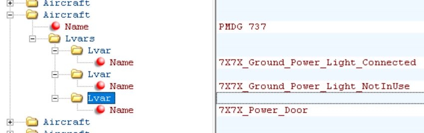

  • Hi Steve, set the related Lvars (7X7X...) manually to KnownLvars.xml and checked with XML Notepad, no errors.
    After Starting MSFS and GIT and LUA code assignement, the Lvars were wiped out of the KnownLvars.xml file. The Lvars are not visible in LUA console and the error message is the same as above, it is not working. For the getkvar function I found in the Online LUA description that it is not available in GIT FS2020. So it seems that PMDG B737 in FS2020 did not accept any additional entry, at least for me... (tried with knownlavars.xml writing protection too, but the error message is the same) Best regards Ralf
