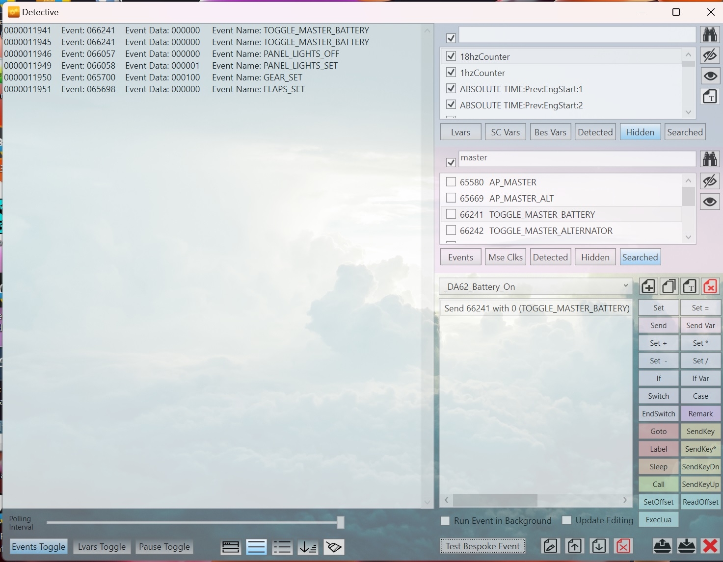

But I now have a different problem with a specific aircraft. The Vertx DA-62. This was created for P3Dv4 but I had it working fine in v5 on my old machine.
But with the new computer something odd is happening and I can't resolve it. The main Battery switch uses the default TOGGLE_MASTER_BATTERY command. When I monitor Events that command gets called once. But when I add either a new Bespoke Event for that command or even just the Functions on the T8 Switches display it gets executed twice. So it keeps turning on than off instantly.
Any clues why that might be happening? I appreciate you might not have this aircraft but I'm mystified why the call would be executed twice. It's only called once when the aircraft battery button is pressed.
