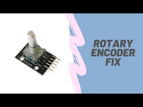

  • You may be able to simply clean it. See from 3 minutes in on this vid: https://www.youtube.com/watch?v=lylpr1anaLg&t=182s&ab_channel=Astro%27sElectronicsLab
  • Steve, you are a genius. I managed to open this up and unsoldered the F/O course rotary encoder joint and cleaned it and it seems to be responding just like the others now.
    Only thing I see is just the a slight delay in the numbers changing and this is on all encoders so I am thinking it may have something to do with some outdated soft or firmware. I am currently running A24 on the MCP PRO.

    The enconder in the Goflight was a three (3) pin unit compare to the 5 pin I see in the video above and on Amazon. I was hoping to buy a couple on standby just incase mine craps out completely. What are the difference between the 3 and 5 pins?
  • Awesome! Since you have A24 firmware, you can set the Write and Cmd Delay sliders on the GIT MCPPRO tab to 0. That should help with any delays.
    Not sure about the pin outs. Usually there is a part number on the encoder. Just google for the part number and you should be good.
