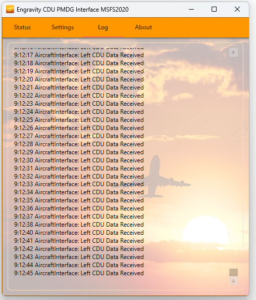

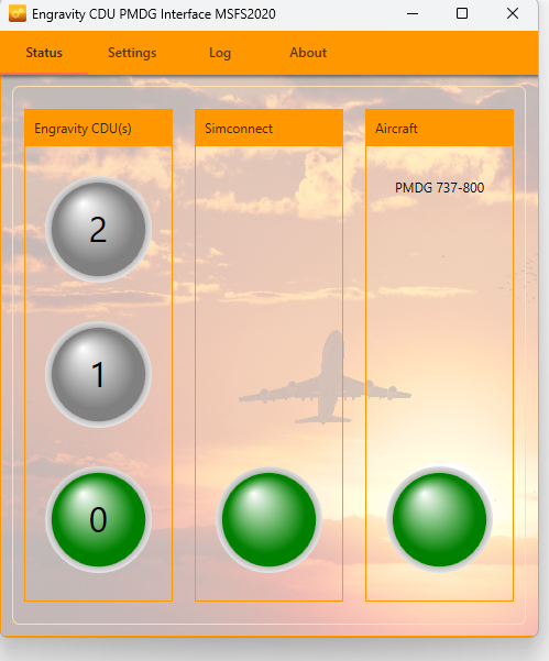

I have the problem that I don't have a complaint with the CDU. In the status of the cdu PMDG interface, all three points are green and the log says: AircraftInterface: Left CDU Data received. but nothing else either.

exactly the CDU always goes into standby.

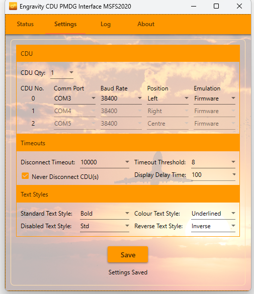

With EXEC + S I can open the settings page and the data agrees with the interface.
Unfortunately, the solution suggested above was also unsuccessful. I also tried other USB ports without success. In Hardware Manager: "The drivers for this device have not been installed." but I can't find any drivers.

the problem is solved. I reinstalled Silicon Labs CP210x USB to UART and after that it worked.
