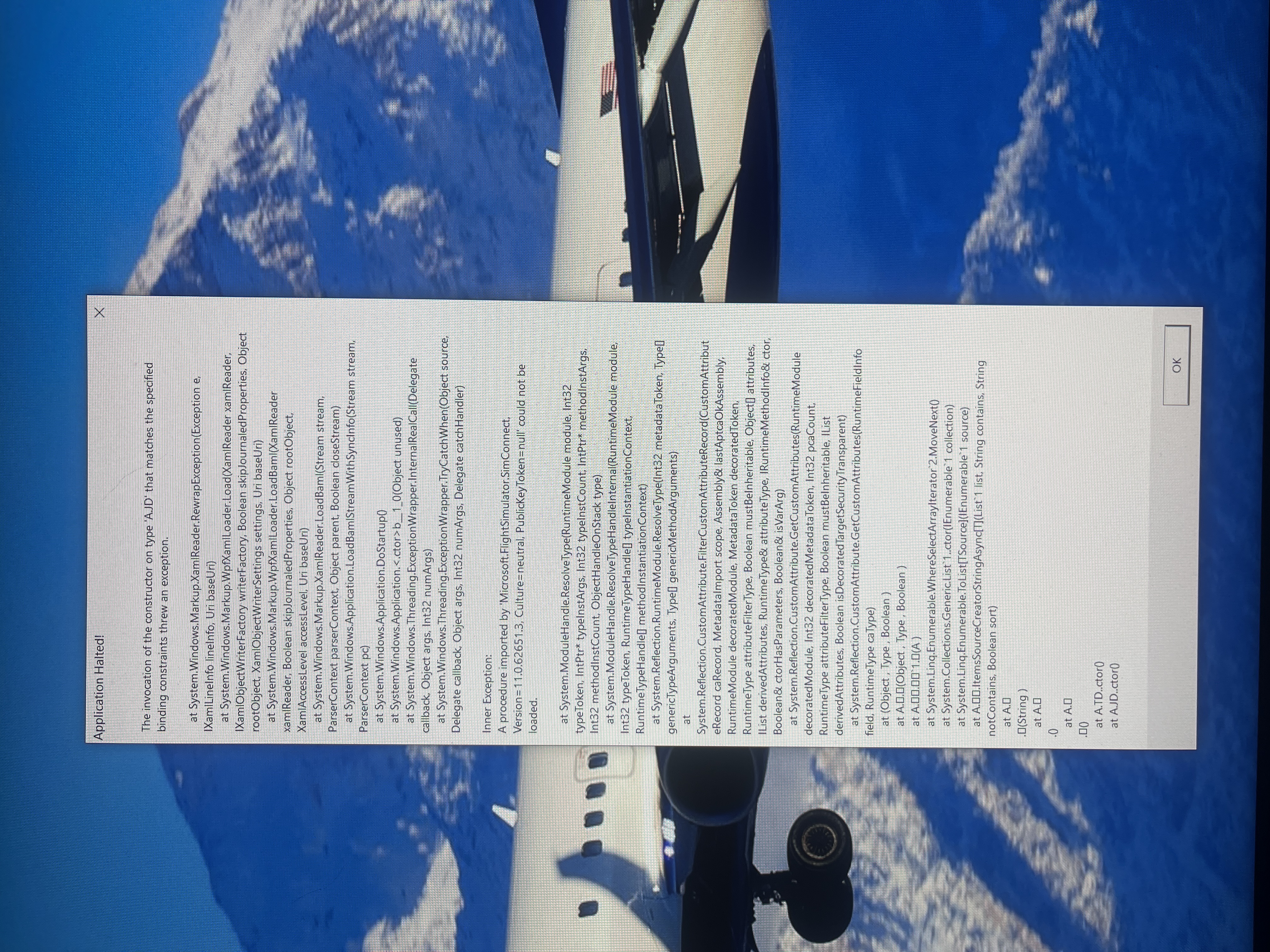

Hey Steve,
Not sure what is going on here but the Goflight interface tool MSFS is throwing this error. I did have a video driver crash yesterday with a black screen. Had to do a hard reboot. I did a uninstall and reinstall but still getting this error. Goflight interface tool for x-plane is working fine.
Ben

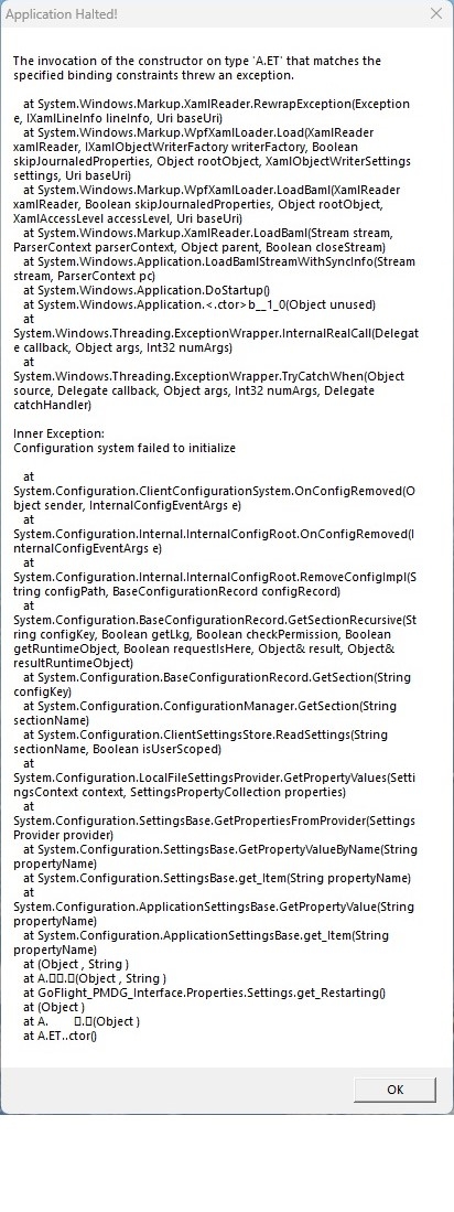

  • Delete the directories in C:\Users\\AppData\Local\PollyPot_Software
    This will delete the corrupt settings file. It will not remove any aircraft configs, so don't worry.
  • That did the trick, all is working now. Ya know after you start flying with hardware like the GF-MCPro there is no going back, can't fly without it. Back to happy Sim.
    Thank you boss!
    Ben
  • I deleted the corrupt settings file, launched and it brought me to the user agreement. I then him I agree and it threw the same exception at me. Is there something I'm doing wrong?
  • edited July 9
    You probably have corrupt aircraft files. If you have a backup of Documents\GoFlight Interface Tool, restore that directory from backup, otherwise you will have to delete the files (take a copy first just in case its something else) and let GIT recreate them, but you will lose your aircraft configs.
