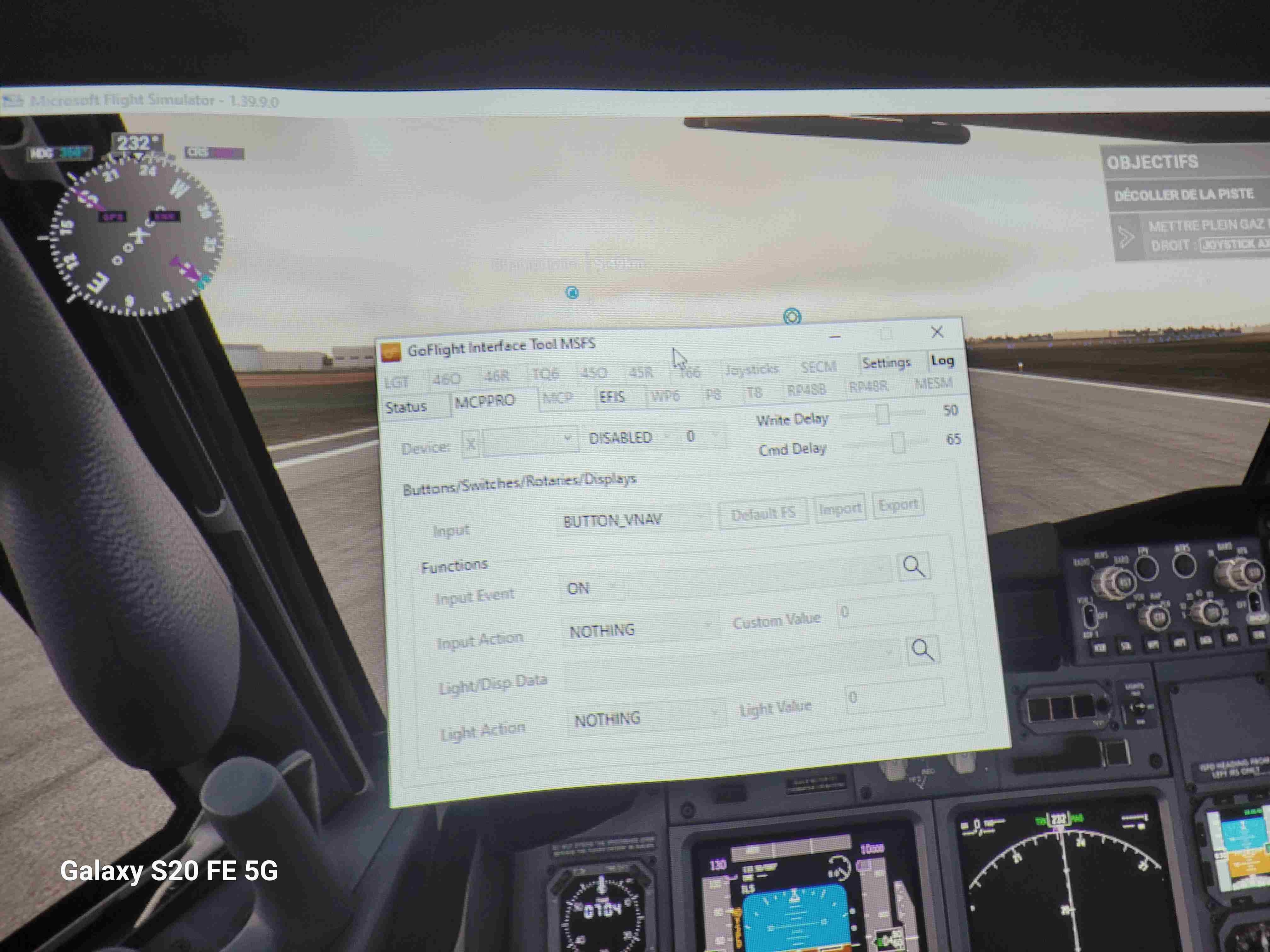

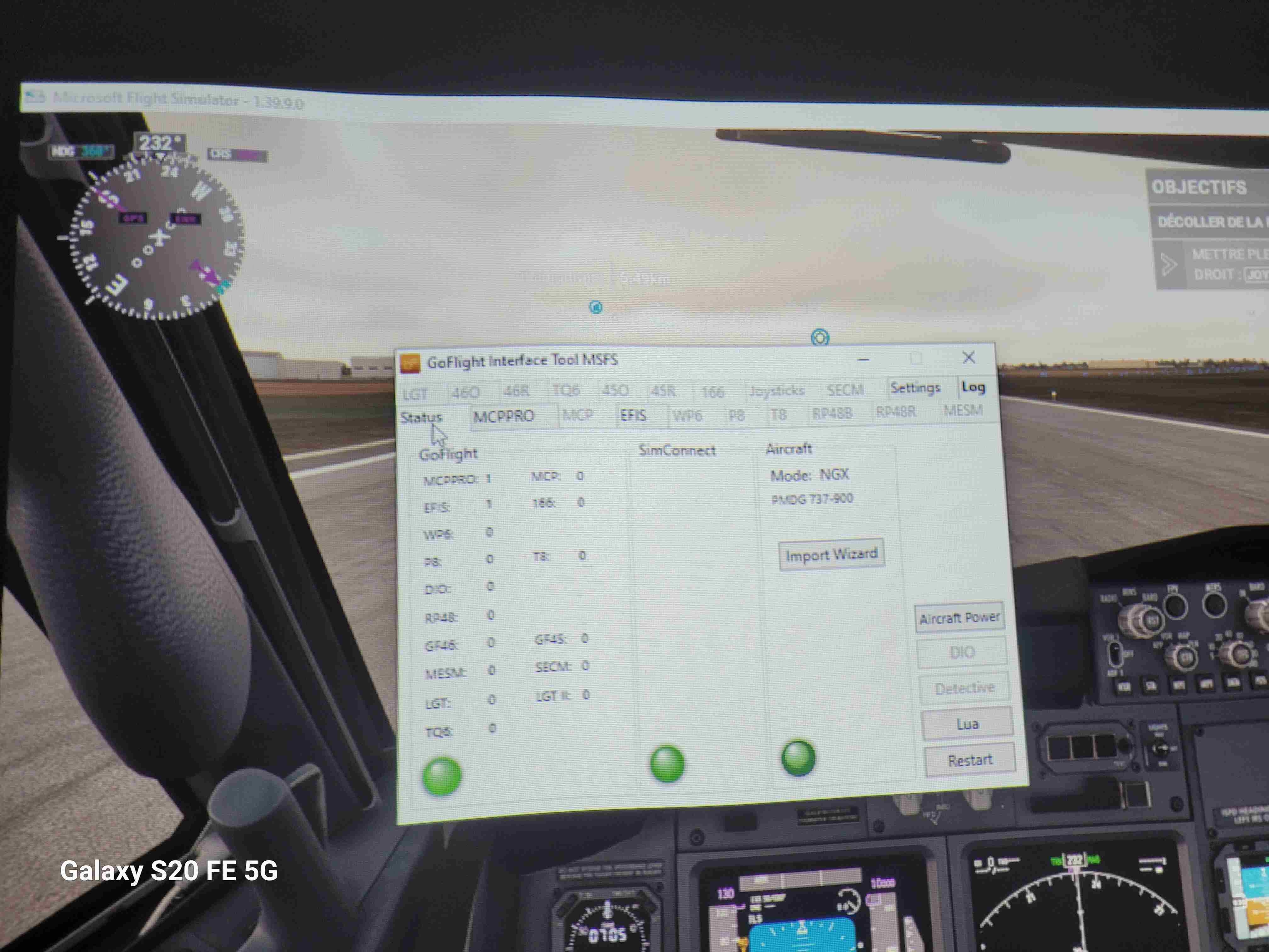

I am using a PC running Windows 10 with MSFS 2020 and the PMDG 737. I have two GoFlight devices: an MCP Pro and an EFIS, both of which worked fine with FSX in the past. I installed GIT MSFS, and now the EFIS works correctly, but the MCP Pro does not: the displays are black, and the knobs and buttons are unresponsive.

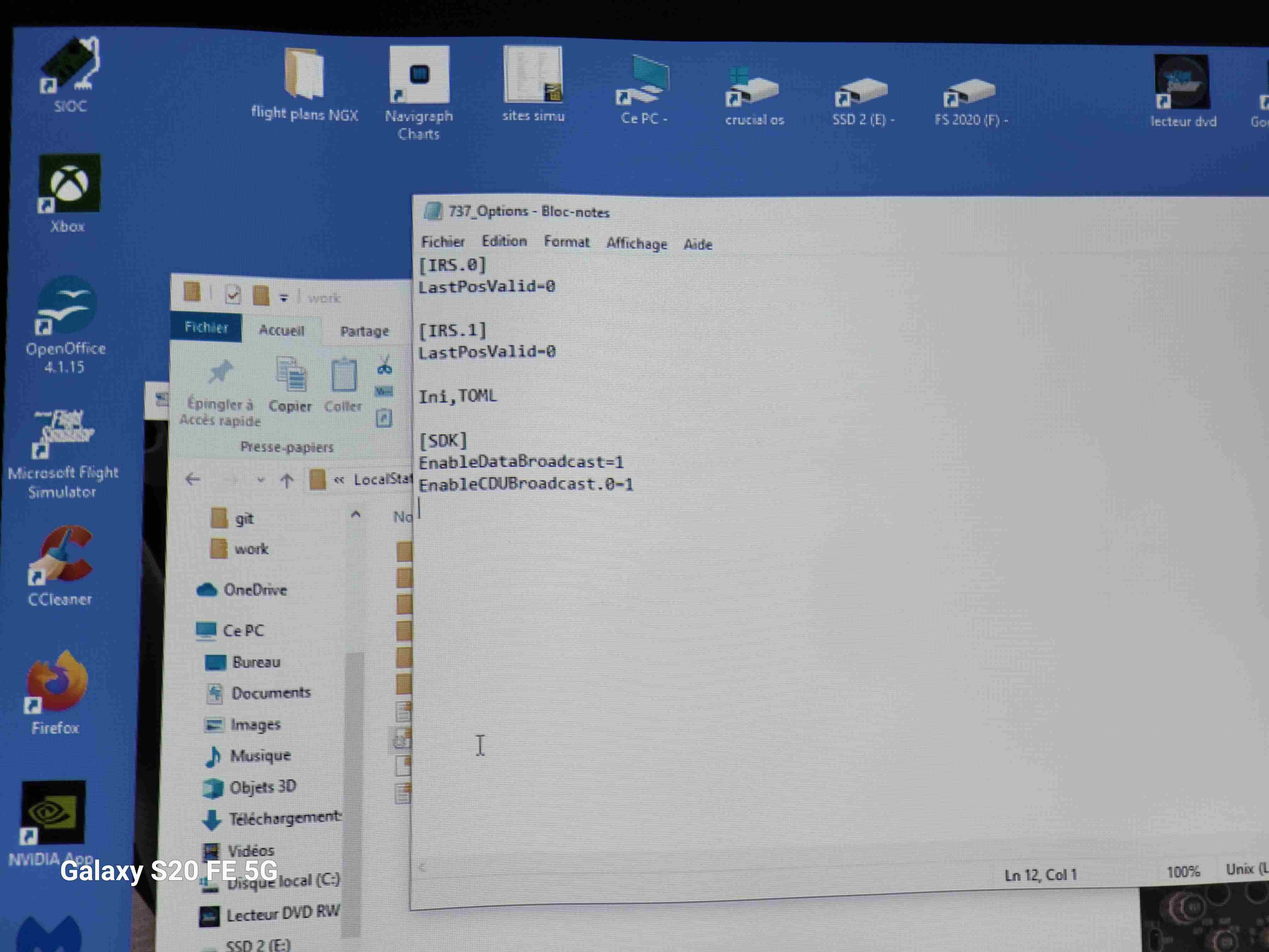

I verified that EnableDataBroadcast=1 is present in the 737_Options.ini file (see attached).

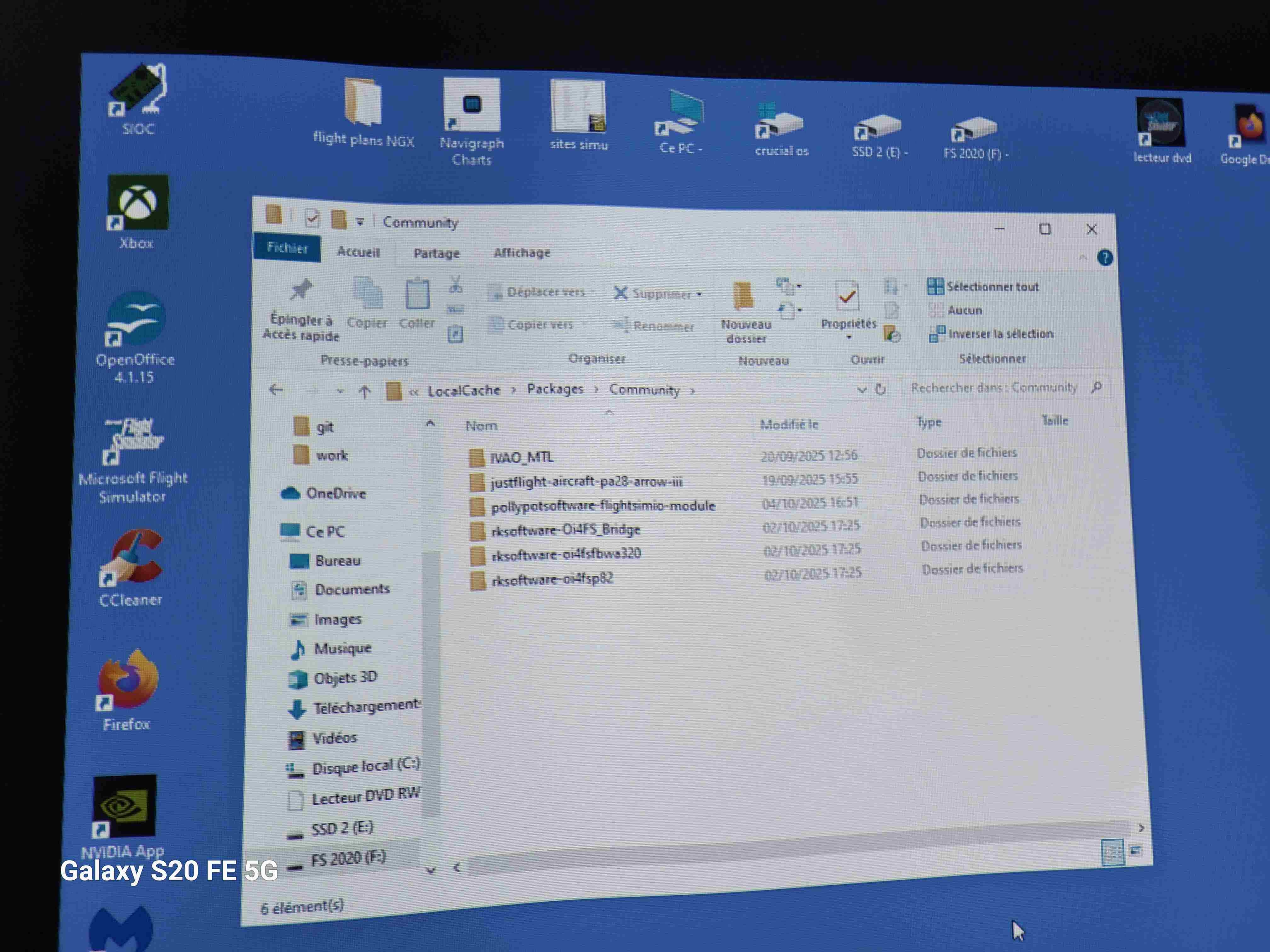

I confirmed that the pollypotsoftware-flightsimio-module is present in Microsoft.FlightSimulator_8wekyb3d8bbwe\LocalCache\community (see attached).

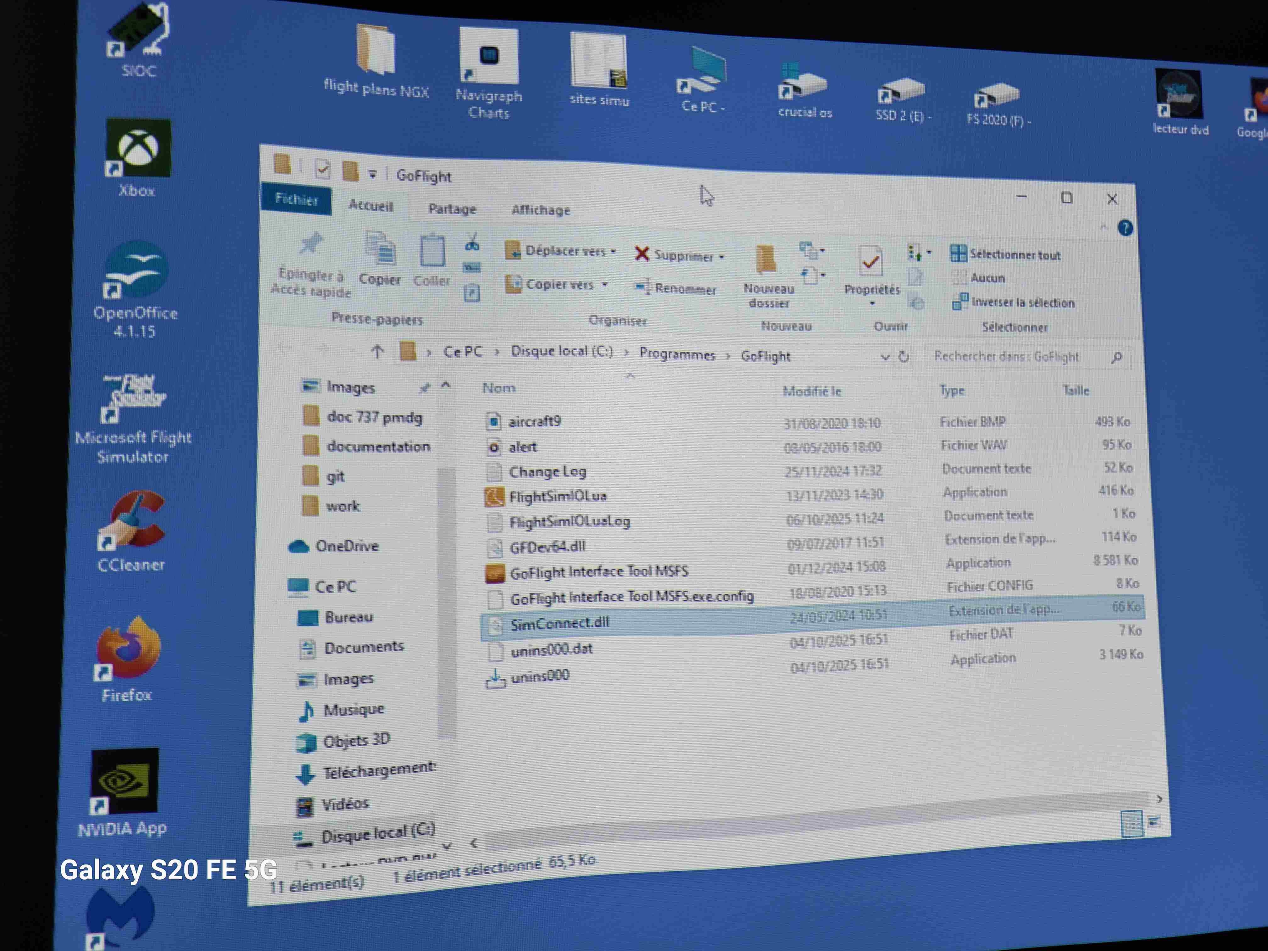

I previously installed GoFlight drivers (GFConfigSetup_2_28_0-2) before GIT. When I learned that GoFlight drivers are not mandatory for the PMDG 737, I uninstalled them, but this did not resolve the issue.

  • Can you check that the MCP Pro is enabled in GIT (you will need the 737 loaded with the cockpit showing to actually confirm its enabled for the 737.
