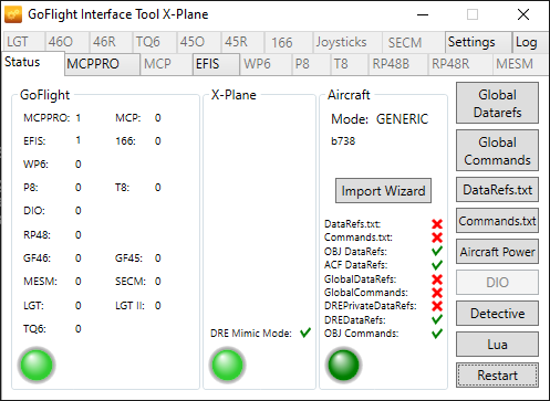

GIT not working with hardware, despite following the beginners guide, and having 3 green lights
Win10 21h2 x64
MCPPRO & EFIS
XPlane 12

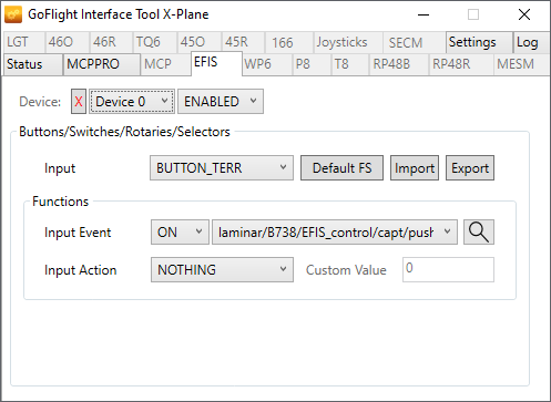

Ive finished the begginers guide with no success. Tried reinstalling it all twice. DK what is the problem, i think it' s related to datarefs.txt, commands.txt or something.
I' ve tried only with b738.zip profile (from downloads, xplane tab) and only get zeros on the display, and no response from mcppro hardware. I've attached screenshots for more information.
note: last thing i' ve tried is pressing "default FS" in both "efis" & "mcppro" tab, which idk if that is correct, is that the button of the step 4 from begginers guide? quote "Click the button that will automatically configure the device." dk what button is that, thank you in advance.
log
17:32:02 GoFlight Connection Starting.....
17:32:02 X-Plane Connection Starting.....
17:32:02 GoFlight Connection Started
17:32:02 X-Plane Connection Started
17:32:02 Aircraft Connection Starting.....
17:32:02 X-Plane: Event Received: Aircraft Loaded/Flight Loaded
17:32:05 WinSock: Connected To localhost On Port 27015!
17:32:05 LUA Processor: Started!
17:32:05 Aircraft Connection Started
17:32:05 Synchronising Switches & Selectors .....
17:32:05 Synchronising Switches & Selectors: Waiting for X-Plane .....
17:32:16 LvarNamesUpdated!
17:32:16 Creating Bespoke Vars
17:32:16 Bespoke Vars Created
17:32:16 Importing Bespoke Variables
17:32:16 Bespoke Vars Assigned, Importing Bespoke Events
17:32:16 Bespoke Events Temp Imported
17:32:16 Bespoke Events Imported
17:32:16 Loading Aircraft Settings
17:32:16 GetXMLConfigData
17:32:16 GotXMLConfigData
17:32:16 Loading Power
17:32:16 Loading MCPPRO
17:32:16 Loading EFIS
17:32:16 Loading P8
17:32:16 Loading T8
17:32:16 Loading RP48
17:32:16 Loading MESM
17:32:16 Loading WP6
17:32:16 Loading LGT
17:32:16 Loading LGT II
17:32:16 Loading GF46
17:32:16 Loading GF45
17:32:16 Loading TQ6
17:32:16 Loading DIO
17:32:16 Loading GF166
17:32:16 Loading SECM
17:32:16 Loading Joysticks
17:32:16 Clearing Displays
17:32:16 Reset Data
17:32:16 Aircraft Settings Loaded
17:32:16 Calling Aircraft Changed
17:32:16 Aircraft Changed
17:32:17 XPlane: Event Received: Sim State 1
17:32:20 Global LUA Event Running
17:32:20 Global Aircraft LUA Event Running
17:32:20 Synchronising Switches & Selectors Complete
