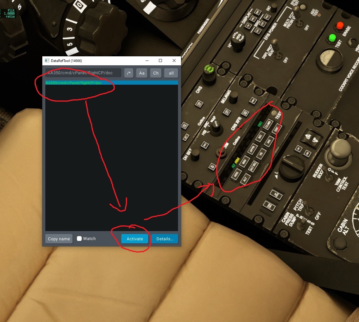

Using the DataRef tool, I have found and tested the cmd line;
KA350/cmd/cPanel/flightCP/dsc
Testing using the "activate" button on the dataRefTool interface works perfectly and activates the descend mode on plane (see photo).

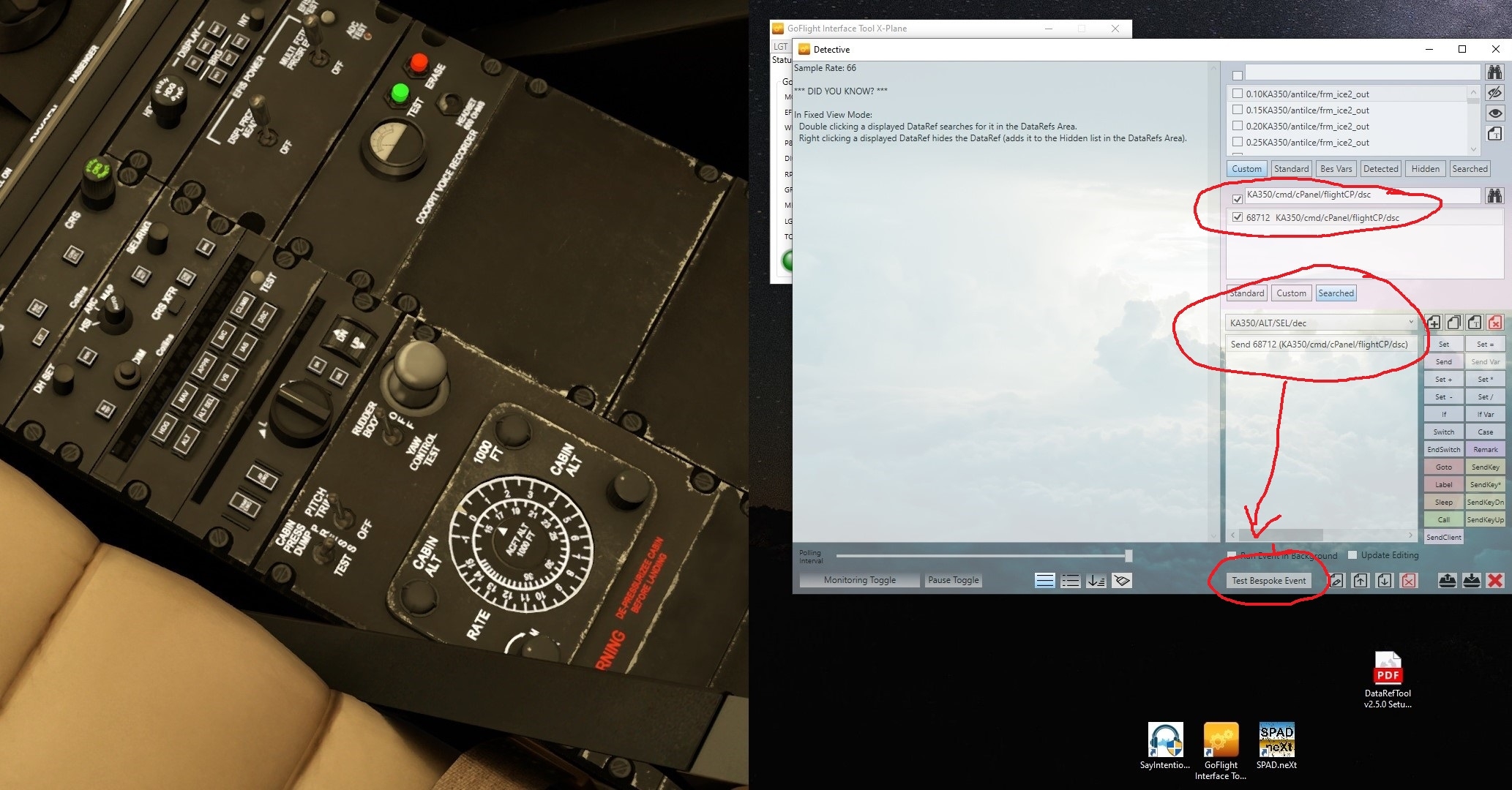

When I then use this command line and create a bespoken event , neither the button or the "test bespoke event "button do anything. (see 2nd photo).
This is driving me crazy and not sure what I am doing wrong. Looking for any advise.
