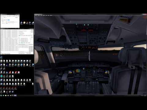

I've tried to get these working, but no luck. Whatever value I set will get reset to it's "current value".
OHD_PNL_LIGHTS_OVHD_KNOB_ANGLE ... I can set the value as it shows up in events/lvars but immediately reverts back to it's original value (values are 0-100).
So I tried the alternate method using CRC generator and found the varlist entry:
electricsData_->control.instlight_ovhd
CRC 76234
In my BE I set the WRITE_CODE=76234 and set WRITE_VALUE=-1 (tried, 0, 1, 50) ... in the VC the control is zero'd regardess of what I set for WRITE_VALUE. It does appear to be hitting the correct element/code, but not the desire results.
Any hints?
