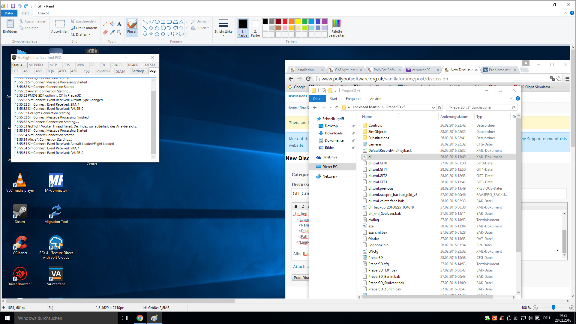

After that i started the GIT and than P3D, i choose the PMDG and that ist. The GIT Stop working it freeze nothing happend.
i Cant even click on the button Settings or Status. Only the Simconnect light is green and the other two are Red and freeze.
