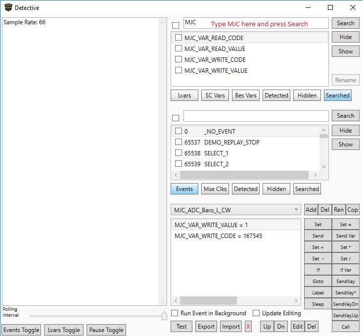

    I get as far as item number 9 which says find MJC_VAR_WRITE_VALUE in the Lvar list
    I cannot find this

    You can search the LVARS in detective It's the fastest way to locate something.
    If you want to know WHAT to send usually with rotary it is 1 or -1 as in the example. You will have to refer to the varlist.xlsx spreadsheet where you look up the names to figure out what are valid values to send (BOOL, INT, etc.)

    Yes Steve, I cannot find the MJC_VAR_WRITE_VALUE
    I have searched numerous times as you have suggested.
    I have also deleted the GFIT several times and re-loaded it, but still cannot find it??

    Make sure you have clicked the Lvars button before typing MJC in the search box. When you press Enter or click Search, the Searched button should be automatically selected and it should be listed.

    Here's a little tip I use a lot if you aren't sure if the function is broke or if it's the switch assignment.
    With the sim running and aircraft loaded, open detective, pick the bespoke event you are wanting to test, then press the test button on the bottom of the detective window. If it works in the detective then it is most likely the switch or dial setting for the panel.

  • G'day again Slayer
    I have done as Steve suggested and deleted the files from My Documents
    I have then reloaded the GFIT and imported the xml file ( 47kb )
    I have not downloaded the GF MCP Pro xml file as I will use my GF MCP Pro as it is
    I can now find the MJC VAR WRITE VALUE line ok
