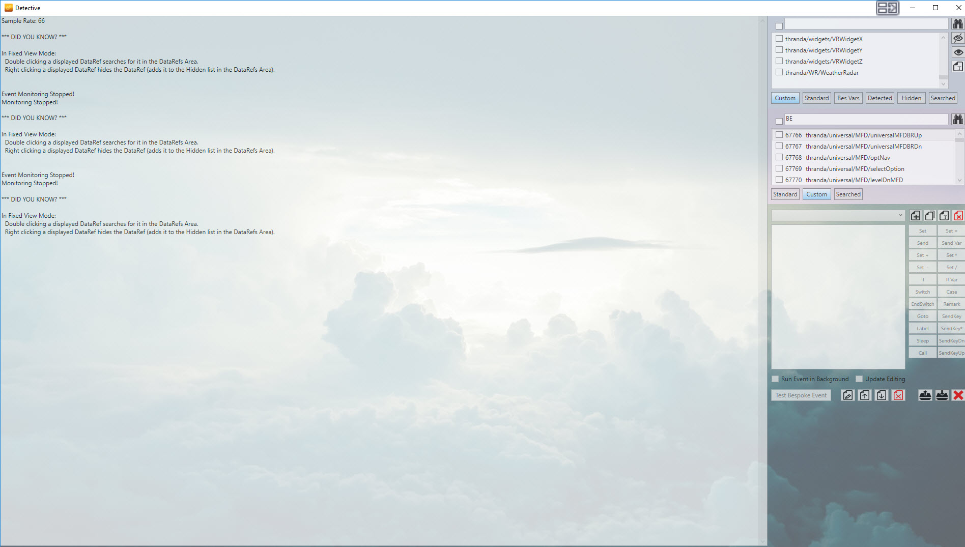

  • Hi Rob.
    Am new to GoFlight-modules and Pollypot-software. Enjoy your videos very much and try to learn more and more...Have one question. In part 1 you ewxplain making a new bespoke-event. Want to hide the commands which have been running after monitoring, but I miss the buttons Hide and show selected commands.....a, I missing something..?
    Thanks for your time and your videos....

  • Hi Rob,
    Thanks for your quick respons. Is video one around 10.42 when you want to hide the commands...I don,t have those buttons...(see photo)
    Thanks...
    Kind regards,
    Anton Will van Zoelen
  • Oh I see, what language is your OS set to? This sounds like possibly wrong VC++ or other runtimes were installed? Assume you have the latest version of GIT?
  • Anton,
    It looks like a bug to me. Try putting the Detective window out of full screen and see if they appear.
  • Good morning Steve,
    No effect, have changed language Windows from Dutch to English (USA). No effect. Is new installment (after saving all my xms-files) an option..?
    Best wishes,
  • Hi Anton,
    I have no idea what is going on here, I have never had this issue reported before. Try uninstalling and reinstalling.
