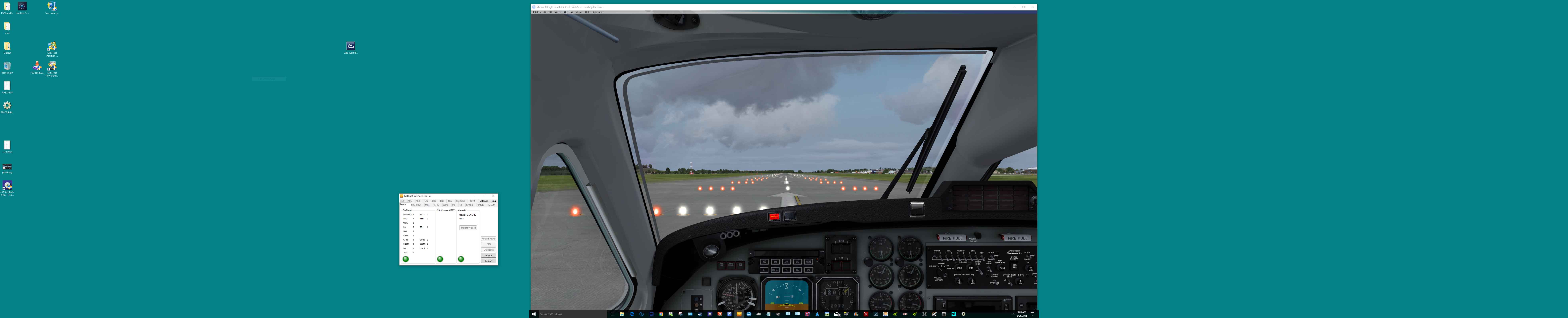

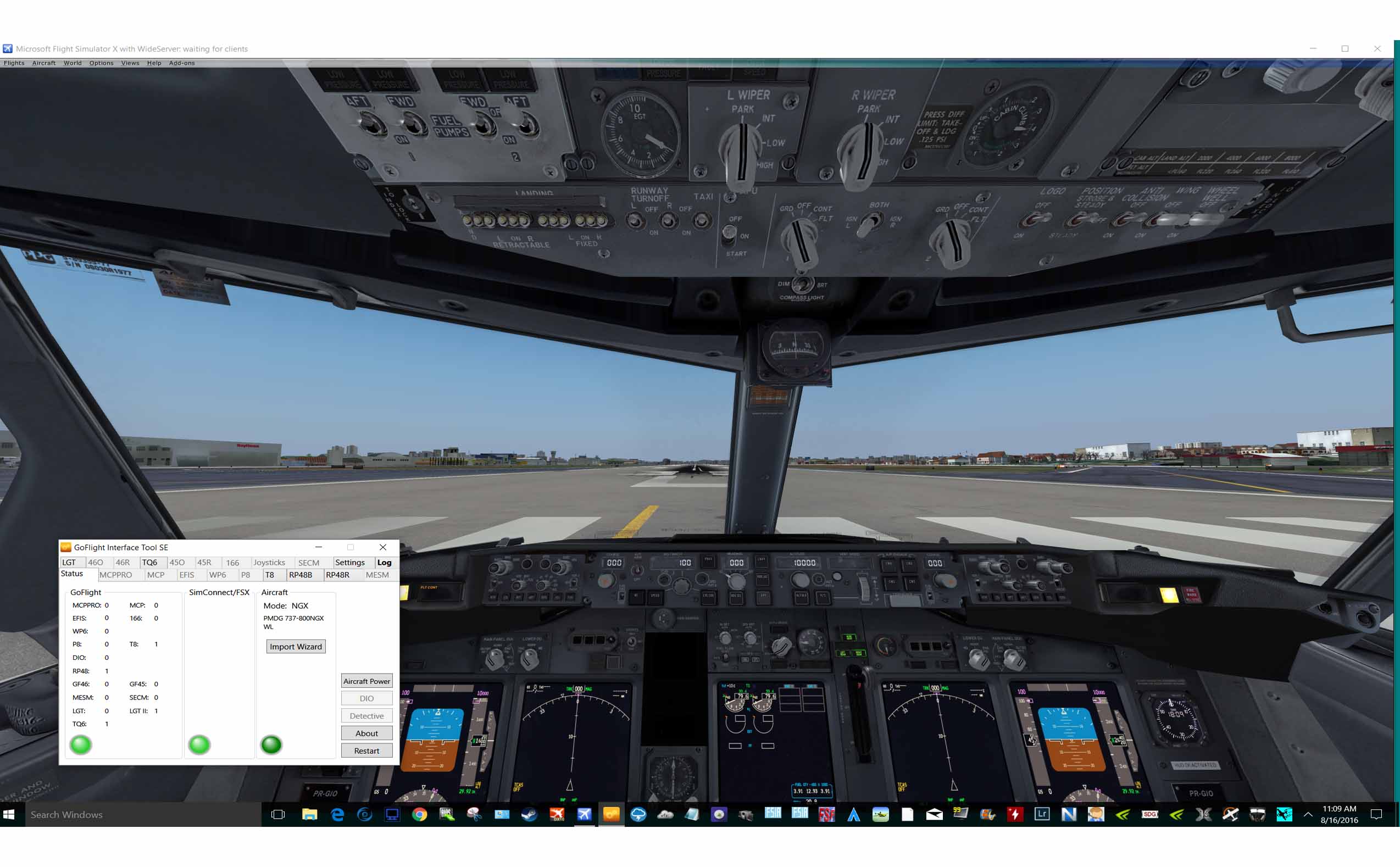

Why can't I see goflight modules/detective?
is there a restriction on which aircraft are supported with this tool?
For example  A2A or Carenado, all modules and detective  are greyout.
Am I doing something wrong? .

    Just an update, I will post here what the issue was so it could help someone else with similar problem.
    My FSX-SE was installed in a brand new windows 10 pro (fresh) but for some reason, FSX-SE created two folder FSX and FSX-SE,  GIT wrote on FSX-SE but it had to be written on the FSX folder, so I just transferred the .dll to the correct folder and everything looks good. So the problem was not GIT but FSX-SE installation.
