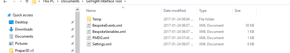

  • DID THAT NOT WORKING IMPORTING THIS FILE...I IMPORTED ALSE BY REMOVING BESPOKES EVENT
  • Not sure what you mean. Did you use the Import Wizard?
  • Now that in the GoFlight Interface tool folder
  • The only thing I can recommend is try importing the config again for the Airbus. If it doesn't work, check that no recent update of the Airbus has happened as this normally breaks configs and events and variables have changed.
  • Did that with no success, and no recent update made to the Airbus, not even default P3d works for the Airbus
