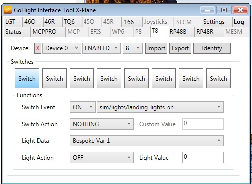

I'm attempting to use the GF-T8 switchs to control the aircraft's lighting (landing lights, taxi lights, nav lights, strobes). I've had success doing this with JROLLINS CRJ200 without the pollypot software, but I purchased the pollypot software just for this reason and I can't get it to work. When I flip the switch (for example, for the landing lights) the switch in the virtual. cockpit doesn't move at all, however in the external view, the landing lights do flash on for a split second then it seems like something within the aircraft's coding overrides my command and they turn right off. I have the same issues with several other payware aircraft. Please help!

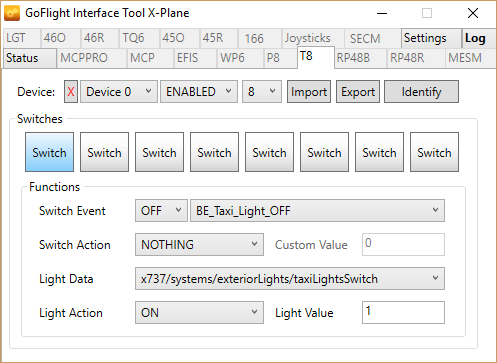

I have created a few Bespoke Events for the lights that should hopefully get you started. Each one begins with BE and is self explanatory. E.g. BE_Taxi_Lights_ON.
You will need to use the Import Wizard to load the attached file. I have not assigned the Bespoke Events to any devices so the device options will remain disabled on the Import Wizard options screen. You may want to consider unticking Delete Existing Bespoke Events to keep yours in place.
Once they are in, you need to assign an ON Bespoke Event to the ON Input Event on a device and an OFF Bespoke Event to the OFF Input Event on a device. The GF T8 is ideal!
For the GoFlight LED's, you need to reference the Dataref used in the Bespoke Events e.g. x737/systems/exteriorLights/taxiLightsSwitch is On when its value is 1 and Off if its 0. They all use the same values except x737/systems/exteriorLights/positionLightSwitch which is -1 when its On.
Hope this helps, but any questions, let me know.
PS. I used version 503 of the EADT 737 for this.
PPS. You need the Battery, APU Running and the APU Gen switches clicked for the actual lights to work!
The reason it is not working is that you have not referenced any of the work I did for you. Lets start off simple and configure the Taxi Lights. See the attached screenshots and notice the use of the Bespoke Event beginning with BE (these are what you must use) and the x737 DataRef for the LED's. One screen is for the ON Switch Event and the other shows the OFF Switch Event.
