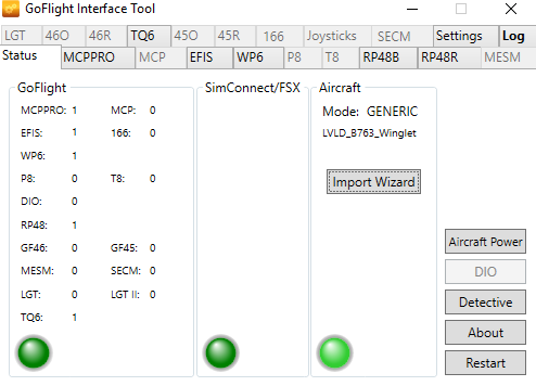

I just bought the Level-D 767 as i've read that it's compatible with the MCPRO automatically, however this doesn't seem to be the case. In the Go Flight Config i've changed the 'mode of operation' to Level D Simulations, yet the autopilot doesn't work. On GIT, all lights show green, however on the Aircraft it simply says "Generic", and under it saying "LVLD_B763_Winglet", i've attached a photo.
I'm unaware whether i'm supposed to use the import wizard to import a config, as there isn't one of the Pollypot website.
Any help would be greatly appreciated!

There is no specific support for the Level-D 767 in GIT - you would need to build a config for it. The GoFlight drivers have support for this aircraft and it definitely worked with the older version of the aircraft with FSX as I used to use it alot. Perhaps the recently updated version of the 767 has broken the support. I would check with GoFlight.
