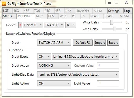

    The issue I still have, and I don't know if it's a GIT issue or a Laminar issue with the B738 is that I can't get the lighting to work from the datarefs that Laminar have documented for the status of the buttons and switches.
    An example:
    • The attachment GIT.jpg is the A/T ARM switch in the MCP tab of GIT. It shows that I'm using the laminar/B738/autopilot/autothrottle_arm_toggle command to toggle the switch.

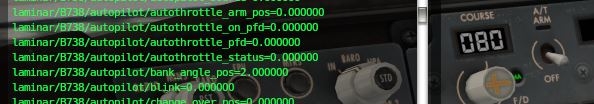

    • The attachment Autothrottle_Off.jpg show the switch in the off position, the light is off and the autothrottle datarefs are 0.000000. The switch on the physical GF-MCP Pro is in the off position.

    4. however, the physical light above the A/T Arm on GF-MCP Pro does not illuminate.
    Any feedback is appreciated. GIT is a fantastic interface and I'm almost there, apart from one or two issues.

    Thanks for your comments. I tried toggling the A/T Arm switch, to no avail. When the switch is in the up position the dataref .../autothrottle_status remains 1.
    Went back to the Detective to try and find out some more information. It's what I didn't find that is more interesting.
    I hid all the standard datarefs and hid all the custom datarefs except the autothrottle_status. I then started the monitor. As expected nothing showed. I then toggled the autothrottle switch up and down and could see the dataref, in the DataRefEditor, changing between 0 and 1. Nothing showed in the Detective.
