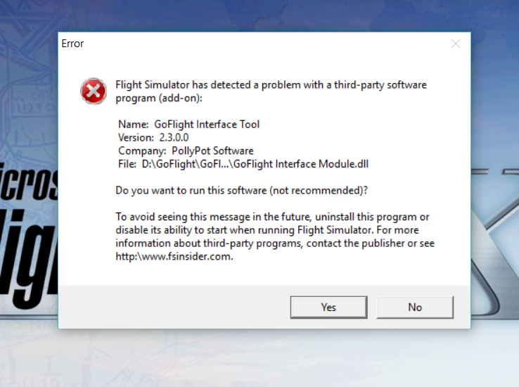

  • When I start FSX I am getting the attached message:

  • Ok, then just click Yes.

  • I took all the files from the "GoFlight" sub folder and put them directly into the main GoFlight folder. Now I am getting that message at boot up of FSX, the one I sent a copy of to you before, that says there is a problem with the GIT and asks me whether I want to run the program. (See past messages for attachment of that screen). I clicked on "Yes", to run the program anyway. Now I finally have three green lights.
