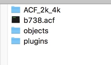

  • 3.30e is a hotfix, an incremental update. It includes a new b738.acf so renaming is no longer necessary. Perhaps your merge did not work. Snapshot shows contents of 3.30e zip file.
  • There's no need to edit files in Planemaker, a straight directory rename is enough.
