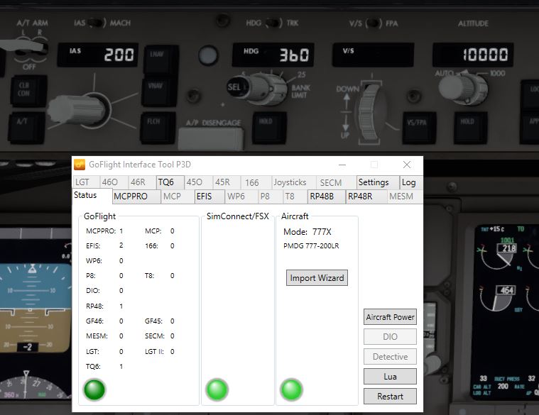

GIT p3 detective blank will not work with pmdg 777 ,PMDG 747 p3d II v 4.1. will work with pmdg737
Works ok with baron , realair duke turbo , MCPPRO works with pmdg 737 v4 but not pmdg 777 or pmdg 747 queen . SDK broadcast enabled on pmdg
most planes with auto pilot work with MCP , TQ6 , RP48
pmdg, 737 , 777 , 747 detective will not work
Go flight interface tool P3Dhas three greens
DIO and Detective windows grayed out
aircraft power , LUA and restart buttons OK
GIT P3D tool
with pmdg 777 p3d

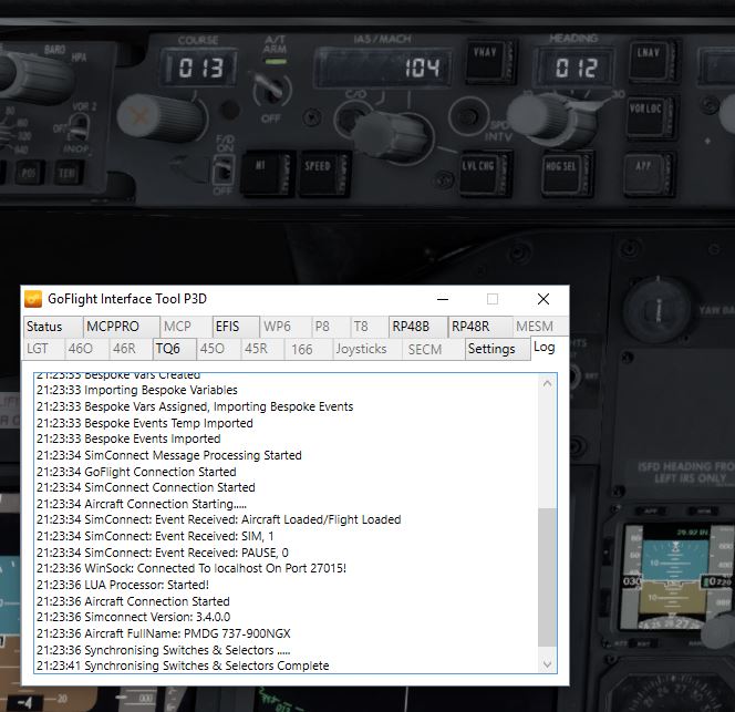

Log
21:03:25 GoFlight Connection Starting.....
21:03:25 SimConnect Connection Starting.....
21:03:26 SimConnect Message Processing Started
21:03:26 GoFlight Connection Started
21:03:26 SimConnect Connection Started
21:03:26 Aircraft Connection Starting.....
21:03:26 PMDG SDK option is OK in Prepar3D v3
21:03:26 PMDG SDK option is OK in Prepar3D v4
21:03:26 SimConnect: Event Received: Aircraft Type Changed
21:03:26 SimConnect: Event Received: SIM, 1
21:03:26 SimConnect: Event Received: PAUSE, 0
21:03:26 SimConnect Message Processing Finished
21:03:26 GoFlight Connection Starting.....
21:03:27 SimConnect Connection Starting.....
21:03:27 Creating Bespoke Vars
21:03:27 Bespoke Vars Created
21:03:27 Importing Bespoke Variables
21:03:27 Bespoke Vars Assigned, Importing Bespoke Events
21:03:27 Bespoke Events Temp Imported
21:03:27 Bespoke Events Imported
21:03:28 SimConnect Message Processing Started
21:03:28 GoFlight Connection Started
21:03:28 SimConnect Connection Started
21:03:28 Aircraft Connection Starting.....
21:03:28 SimConnect: Event Received: Aircraft Loaded/Flight Loaded
21:03:28 SimConnect: Event Received: SIM, 1
21:03:28 SimConnect: Event Received: PAUSE, 0
21:03:30 WinSock: Connected To localhost On Port 27015!
21:03:30 LUA Processor: Started!
21:03:31 Aircraft Connection Started
21:03:31 Simconnect Version: 3.4.0.0
21:03:31 Aircraft FullName: PMDG 777-200LR
21:03:31 Synchronising Switches & Selectors .....
21:03:36 Synchronising Switches & Selectors Complete
still no DIO or detective button?
GIT P3D tool
with pmdg 777 p3d
