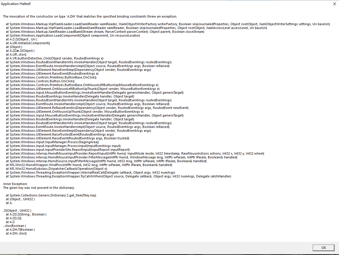

Just updated to the latest GIT for X-Plane.
In the XP11 stock King Air C90B, when I click on the Detective button I get this attached screen, and after clicking OK GIT quits completely.
In the XP11 stock b737, no issues using the Detective, it works as expected.
If I delete the Commands.txt and DataRefs.txt (installed by the XP11 installer) in the plugins folder of XP11. Detective works as expected in the stock C90B.
Thanks for looking in to this issue.

Thank you for the quick update release. Problem solved with v2.0.3.0.
