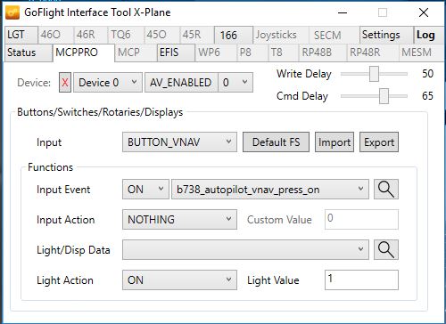

Upgraded to GIT 2.0.4.0 and have an issue with the laminar/b738 datarefs.
Ran the installer (as administrator), delete the /documents/GoFlight Interface Tool directory, started x-plane, started GIT.
Reimported the bespoke events through Detective and imported each of the profiles for the devices.
When I look at the MCP-PRO tab the input dropdown details are displayed correctly but the light/Disp Data dropdown details are blank. When I expand the dropdown, there are no datarefs for laminar/b738/.. only the bespoke variables and the sim/... datarefs. (refer attachment)
I've attached the SettingsXPlane.xml, which shows the light datarefs correctly.
Appreciate your advice.
Thanks.
Thanks.
I will need your files that you are importing to fully test it as when I look at the drop down list, all the bespokes are there, but if you scroll past them, everything else shows up.
PS, I'm assuming default 738 in XP11 latest version?!
A new version is up that fixes the problem.
