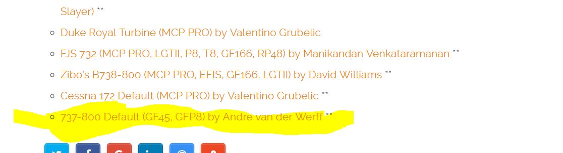

i'have a Effis et MCP Pro goflight
i buy Gogflight Tools for Xplane 11 .
i download Wizzard compatible for 738-800 Zibo all it's OK
i download Wizzard compatible for SSG 747-800i v 1.5.1 only Effis ist OK ,
MCP Pro ist not ok it's ON , Diplay Light but not action on the button
my SSG 747-800 it's the version 1.7 you think the problem comes from there
thanks for your help

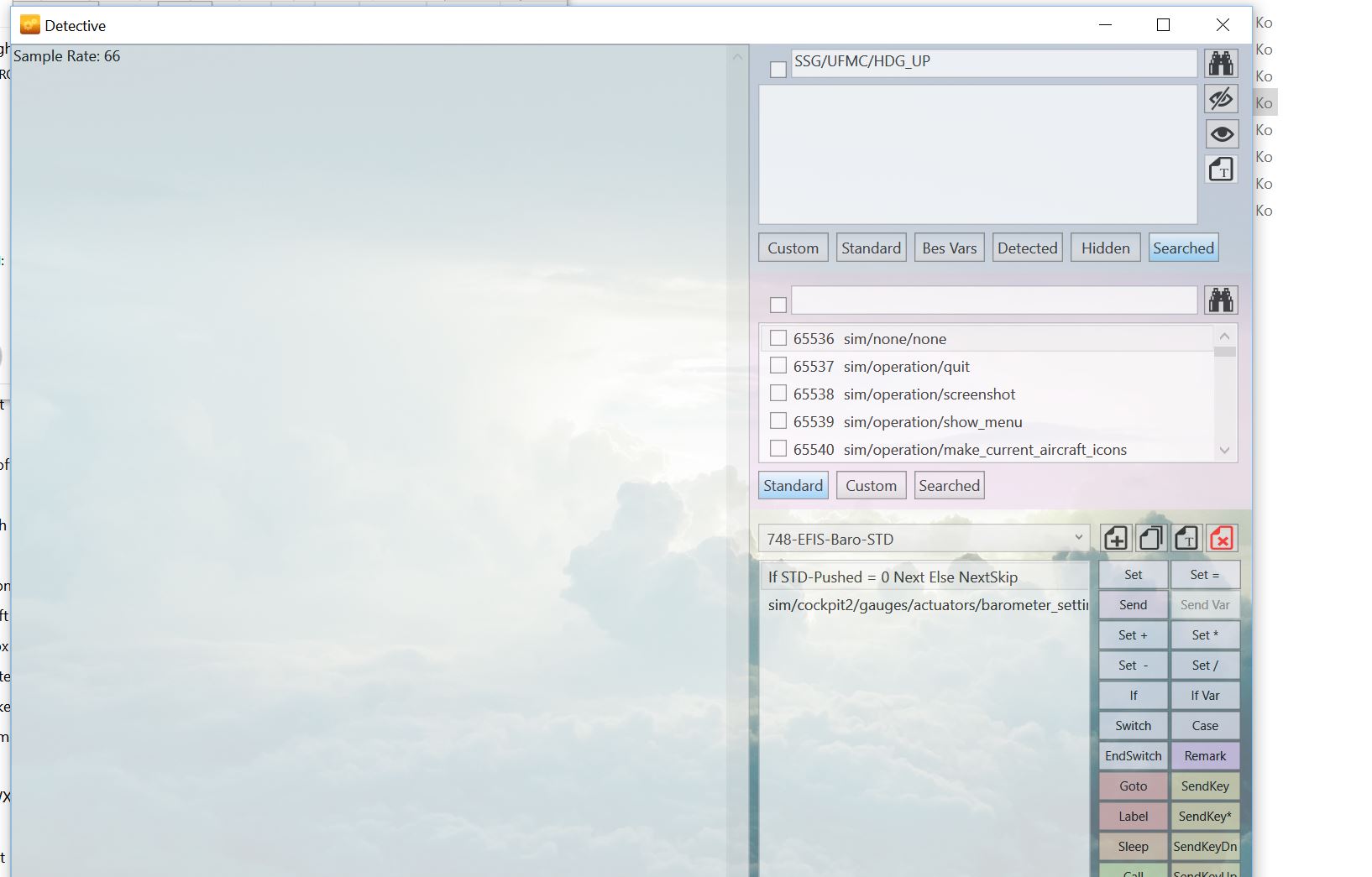

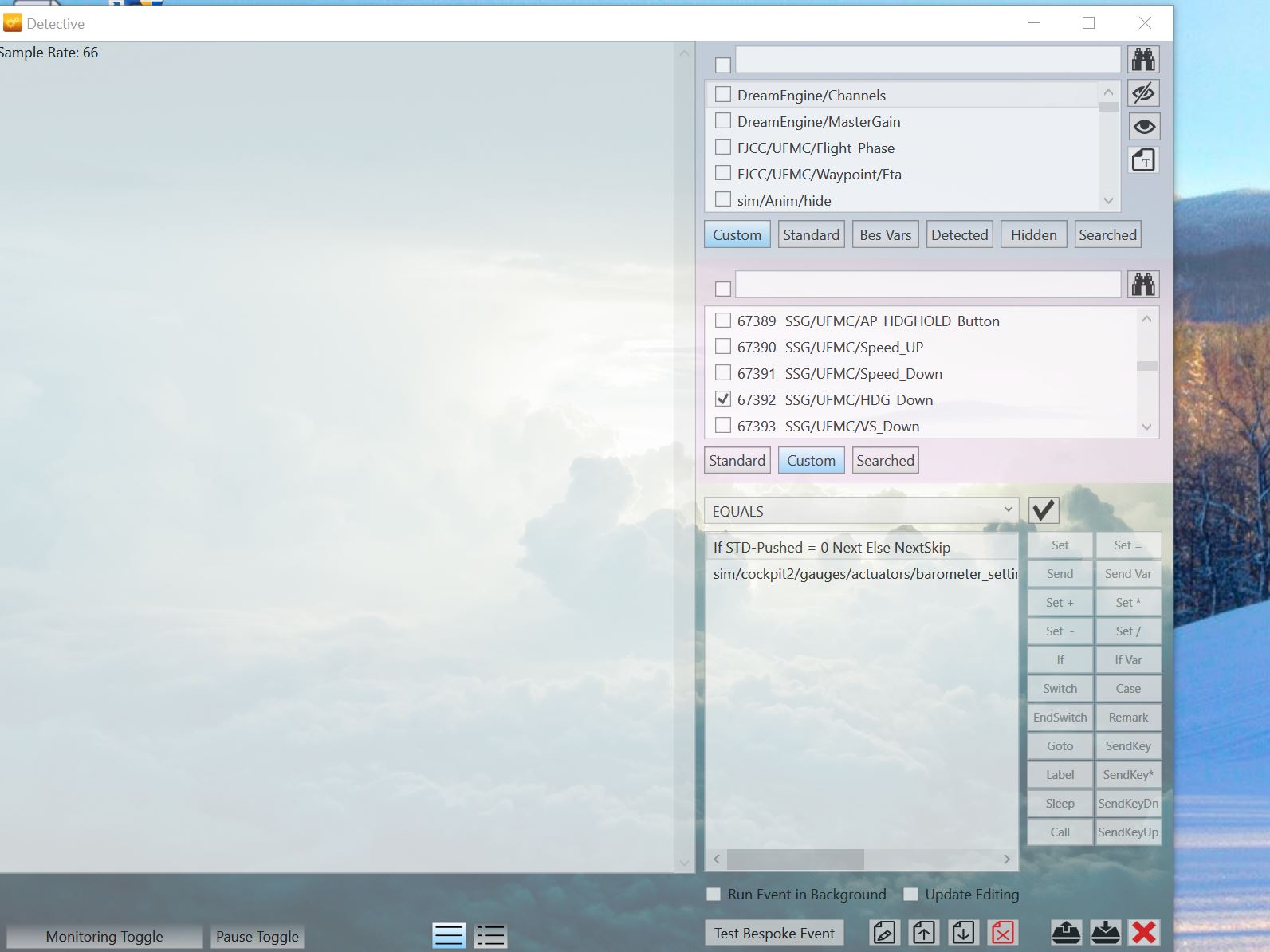

  • OK, With the SSG loaded up and the virtual cockpit showing, can you go into Detective and in the Events section, click the Custom button and see if you can find "SSG/UFMC/HDG_UP". If it is there, can you see if you can change the heading via the Heading Rotary. Let me know the outcome.
  • OK I do that this evening because I am work now and i give you the result
    thanks
  • so there is not SSG/UFMC/HDG_UP see attached files

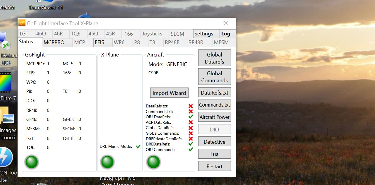

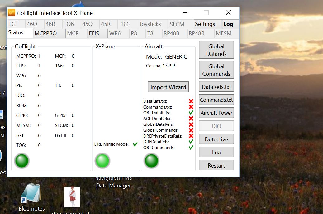

  • another test : about Cessna 172p, King Air C90 the MCP pro is down all in off nothing .
    I talk about ALT/Heading/LOC/App....
    and no import Wizard only generic
    see attached Files
    thanks
  • Looking at your SSG images, you looked at the custom datarefs instead of custom commands. Please look again in the right place.
  • edited November 2017

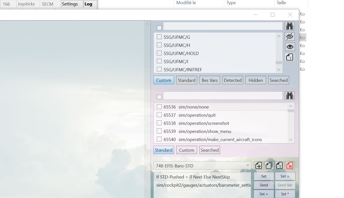

    ok but there is HDG down and not up...see files
    and its the same story : MCP pro no ok
    thanks
    go4.JPG 154.9K
  • This might indicate a problem in GIT's new Command/Dataref detection routines as I would be surprised if SSG had removed the HDG Up Command.
    Obviously, you can't send me the relevant aircraft files to look at as they are copyrighted. However if you could open up the .acf and .obj files in the aircrafts root directory using a good editor like Notepad++ (freeware) and search for the command. If you find it, can you copy and paste the whole line and a couple of lines above and below it into a new Notepad++ text document and attach it on this thread, I can see why GIT isn't picking it up.

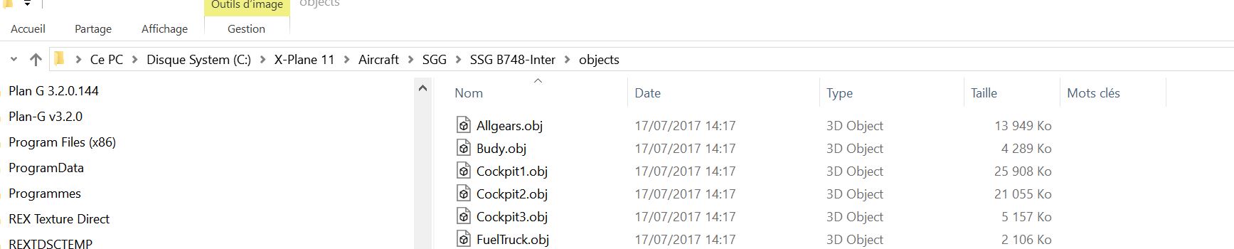

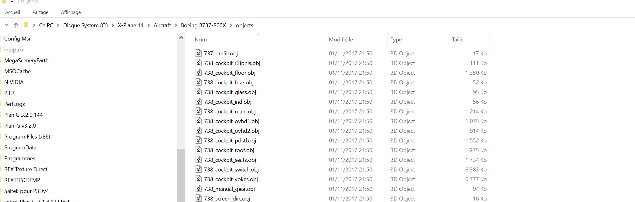

  • Nothing in those files. Any other obj files in sub directories?
  • which one do you want ?
    obj1.JPG 140.3K
  • the two files with main and switches in their filename.
  • sorry is error is not files off SSG 748-800i but is Zibo ok
    so the good now but not main or switches
    z1.JPG 69.6K
  • All the cockpit ones. Thx

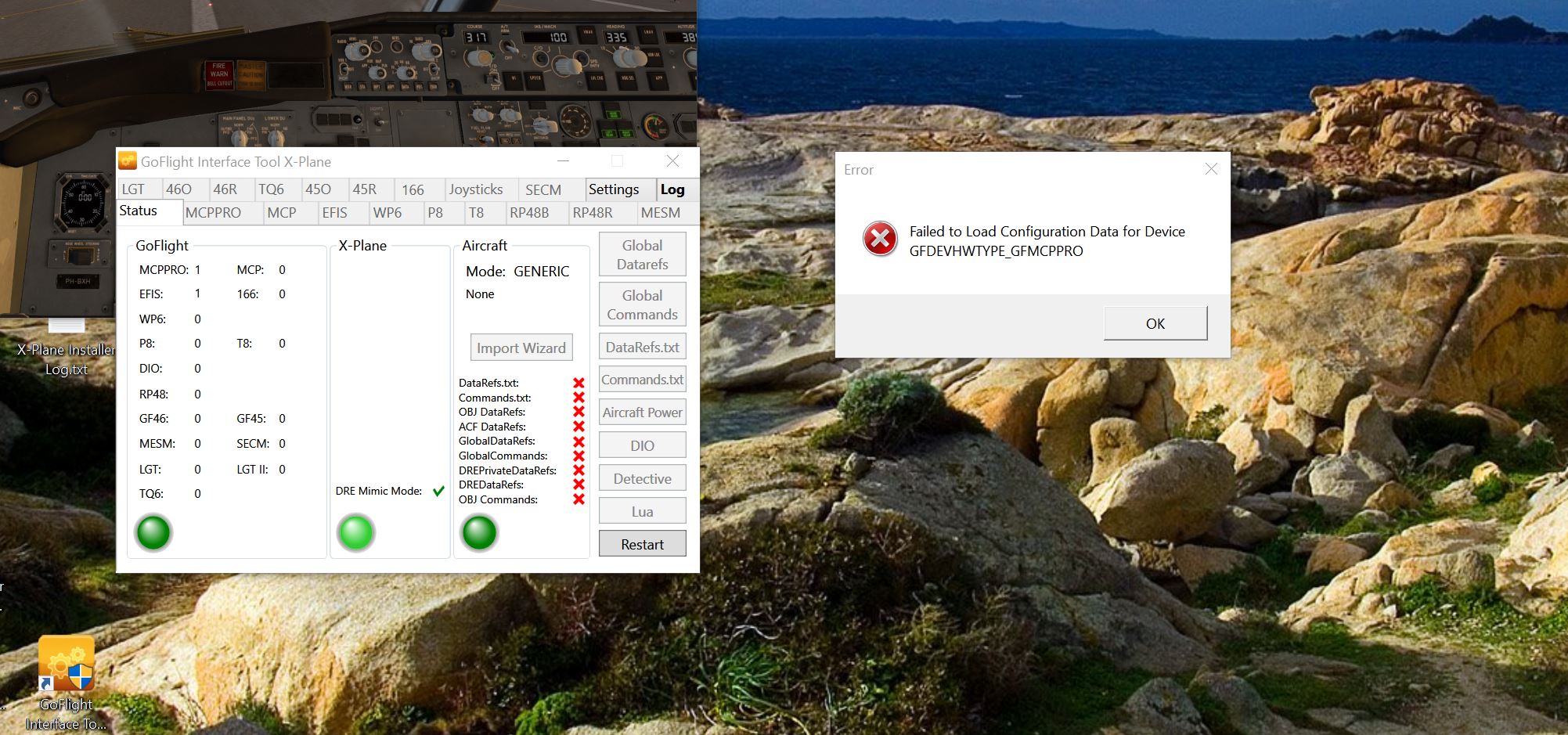

    Just for information the 737-800 default does not work also I have installed the zip file but i have this message this is not problem for me because the Zibo is ok
